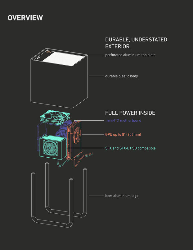

I don’t think it’s too obvious with the material I’ve posted how the internal components are laid out or how the cables would run so I made a little animation to illustrate that.

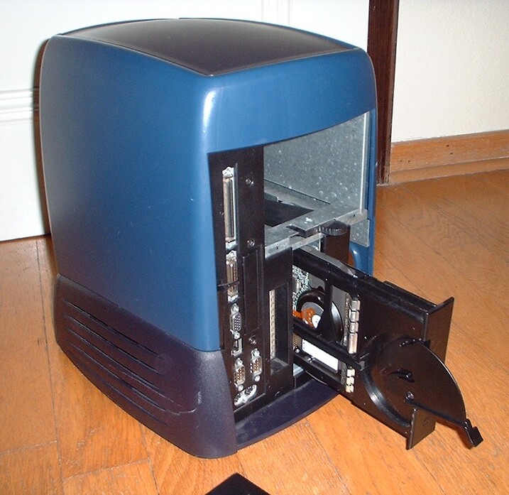

the SGI Tezro and O2 are also weird machines… also way ahead of their time… (Tezro 2003) O2 (1997)
I had an O2, I would kill to still have that machine, the case looks awesome even by todays standards. Had an awesome modular chassis too where each component could slide in and out like a server blade.
I dreamed of having an O2! Takes me back…
Yah, throwback Thursday! I wasn’t familiar with that Tezro model. Did that go to production?

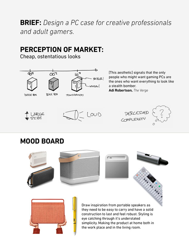

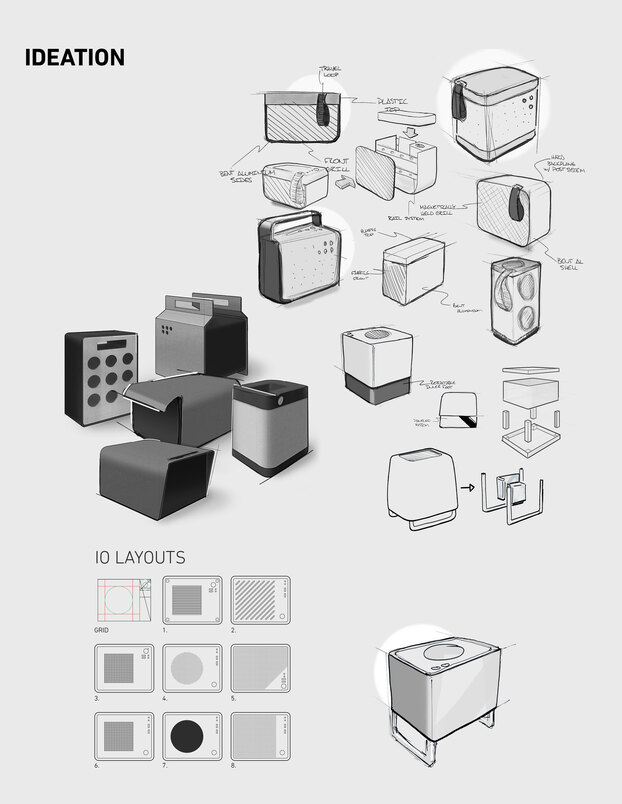

Hey I’m back! I got around to distilling this project down to a portfolio format.
Overall, nothing too new here…
