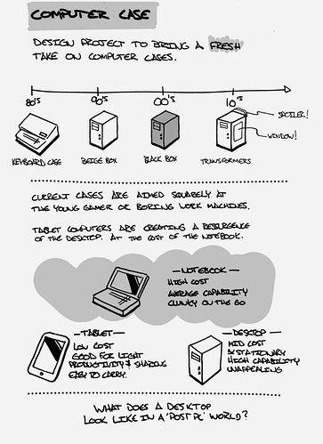

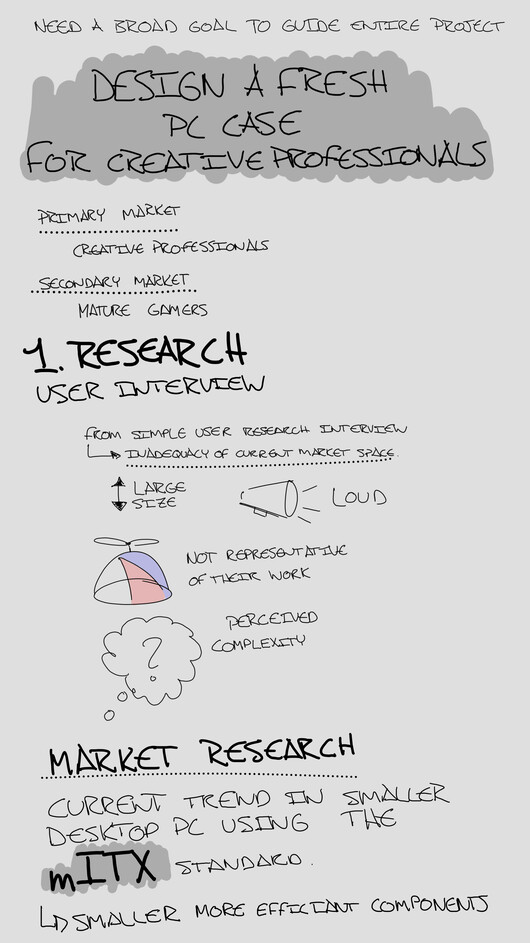

Here’s a quick brief I made for myself.
What I’m seeing is that there’s a resurgence in the interest for desktop machines. Or at least in building them.
My gross explanation for it is that ultrabooks and tablets are becoming increasingly good at replacing traditional laptops for a lot of light productivity applications. Say a student can now use a Microsoft Surface as their only device. A lot of people have relegated their home desktop or laptop as the “tax machine” and do most of their browsing and tasks on a tablet. On the flip side, I’m seeing a need for the desktop machines. The popularity of PC gaming is on the rise, creative/technical professionals have higher needs - video editing in 4k, heavier retouching and storage for photographers, higher quality expectation of output from architects/designers… If a tablet could do most of your busy work and handle your on-the-go computing, you might as well get two devices. A desktop for the desk and grunt work and a tablet for kicking back and being on the go. Rather than a full-size laptop that doesn’t really do well in either situations.
However, the offering I’m seeing for case in the PC market isn’t up there. A lot of it very gaming oriented and looks like cars from Fast and Furious. Or the more quiet offerings are quite boring and still mostly built from bent sheet metal. It’s rattly, tends to look cheap and doesn’t feel like the amazing thing that is a modern computer. The buying experience could also use some work. There’s a lot to take in for the inexperienced to make sure everything is going to work together.
So to kind of wrap up this first post, I’ll take up Steve Jobs comparing tablets to cars and desktops to trucks. -What do trucks look like in a “post pc” world?

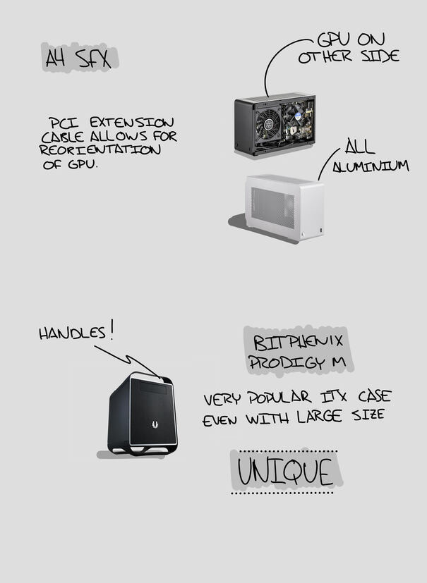

So now for the ‘build your own’ PCs. The EVGA is interesting because it keeps a fairly traditional tower design but can be much smaller by bundling the case with a custom slim server type power supply (PSU). One thing to realize is that the PSU is one of the issues with small PCs. Traditional PSUs are very bulky. And just in the last years have the small alternatives likes SFX size have become recommendable.
The A4 is a community effort and is part of a larger trend of using PCI extension cables to put the graphics card elsewhere than directly on the mother board. These configurations can be very flat like Silverstone’s RVZ series or extremely dense like the A4.
I put the Prodigy M because it’s a very popular case. And it seems to me like the popularity of that case is mostly due to aesthetics. It’s a unique looking machine (kind of looks like an old Mac Pro). It’s also one of the largest ITX cases yet that hasn’t stopped sales. If anything, the large size makes it well known as a fairly easy case to build in.

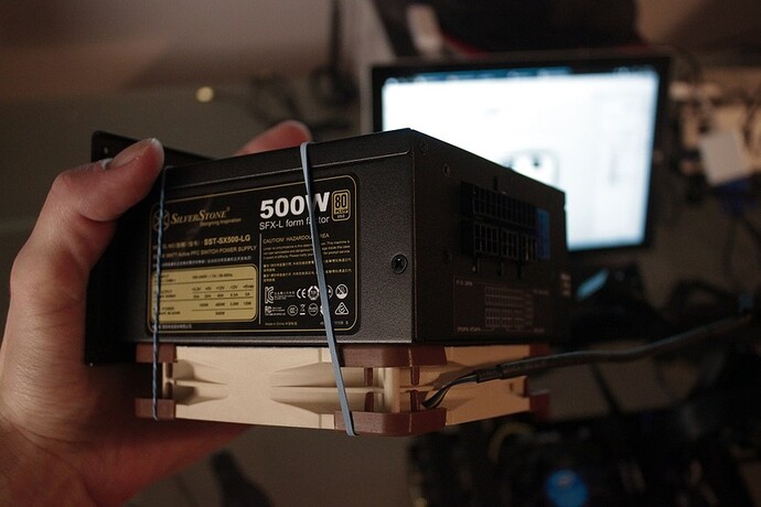

I did run into an issue with my power supply. Even though it was touted as being very quite for a small PSU, it even has a silent mode if the PC isn’t under load, my unit was extremely loud. Loud enough to hear the fan ticking from the next room while the computer was idle. I ended up exchanging the power supply but the replacement was just as loud. So reading online, it seems like most small form factor PSU have issues with noise. Early standards were too small (SFX) and had tiny whinny fans. More recent slightly larger standards (SFX-L like I have) still have some kinks to iron out.
I ended up fashioning my own solution.
I strapped a fan right on the PSU so it states in it’s silent operation due to the continuous air flow. Typically, the fan in a power supply is used as an exhaust though I use mine as an intake and just blow air directly onto my CPU cooler.
It actually made my whole computer much quiter. And actually got me wondering if it would be possible to replace virtually all the fans in a PC with a simple fan right after the power supply. Use a single fan the draw fresh air through the PSU, the directly down onto a heatsink to cool the CPU and finally have the air cool most of the motherboard before naturally exiting the case. This could be a very efficient design versus having a fan for the PSU, one for the CPU and finally one or several just for air flow in the case.

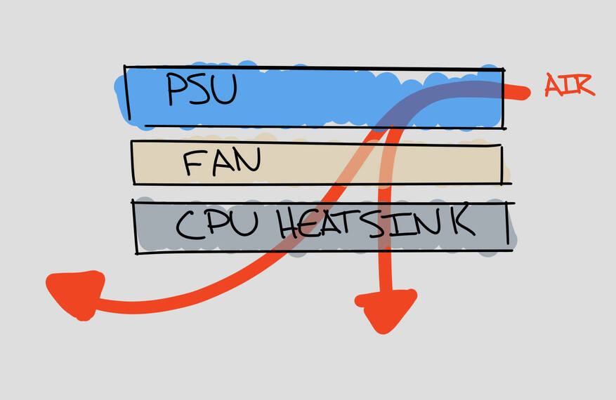

An important thing to consider with airflow is if you are drawing from an area that is hot, you are going to be blowing hot air onto your already hot CPU. Power supplies by their nature run hot, especially when they are smaller and working harder (just pick up your laptop power supply after an hour of rendering). Because of this you’ll be blowing hot air onto the CPU which has an effect more like a hair dryer.
Ideally you want the flow to be reversed - use the fans to extract the hot air from the case which pulls the heat away and will draw air through wherever your intakes are designed. In most cases, the front of the PC case is the intake because the only thing up there are drives which do not get nearly as hot or take up as much space. In cases like the Mac Pro, the vents are on the bottom so that the cool air can be drawn up and out the top since heat rises.
What you might be able to consider is using something like a closed loop liquid cooler (google Corsair H50) that was integrated into your case. If you considered the radiator as part of the design, you could design around it to make it more integrated.
Thanks for the input Cyberdemon :slight_smile:
It may be very unintuitive but I think there might be some merit to using the PSU as an intake in a case where a single large fan would be used to replace an intake fan, CPU cooling fan and PSU cooler fan. I don’t think the direction of the flow matters much.
While the PSU does dissipate some heat it actually is low when compared to the computer as a whole. A full desktop with a high end 100W CPU and mid range 150W GPU wouldn’t go much above 300W when considering other ancillary devices. Considering that it’s quite common to have 90% PSU efficiency, we expect a pretty low 30 W being dissipated at the PSU. If a 140mm fan is running at a pretty high rate, the temperature will barely rise. From some quick napkin math, I’m getting a difference of at most a couple of degrees.
It would just be to find which direction is most practical - that would really come down to the specific case the system would be designed for. However, by drawing air in through the PSU, the actual intake of air could be filtered. On the other hand, by having a negative pressure system or exhausting at the PSU, it would be hard to filter the air intake as it could be coming from basically anywhere in the case. If we’re sticking to the fact that it’s the only fan other than GPU in the case. Also, the downdraft through the CPU cooler could be used to cool the motherboard.
The more I’m looking at this problem, the issue with cooling a computer seems to be with ensuring that air is well exchanged through the case. Making sure that air doesn’t recirculate in the case. We can see this in conventional case designs where a tower cooler’s fan is very close the the computer’s exhaust. Also, in a lot of OEM workstations, ducts will be used to force certain airflow paths. I would imagine this would actually make smaller cases cooler than larger ones if the flow path is efficient.
For liquid cooling. I may have mentally dismissed too early them mostly due to the fairly large overall volume and noise. But I really should give them a second look. They do allow for a very low height clearance above the motherboard while keeping a pretty easy installation.

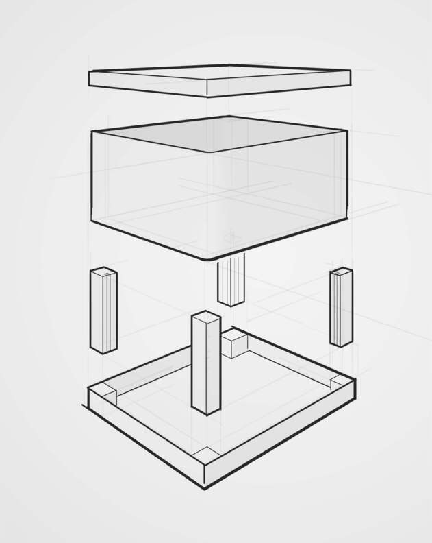

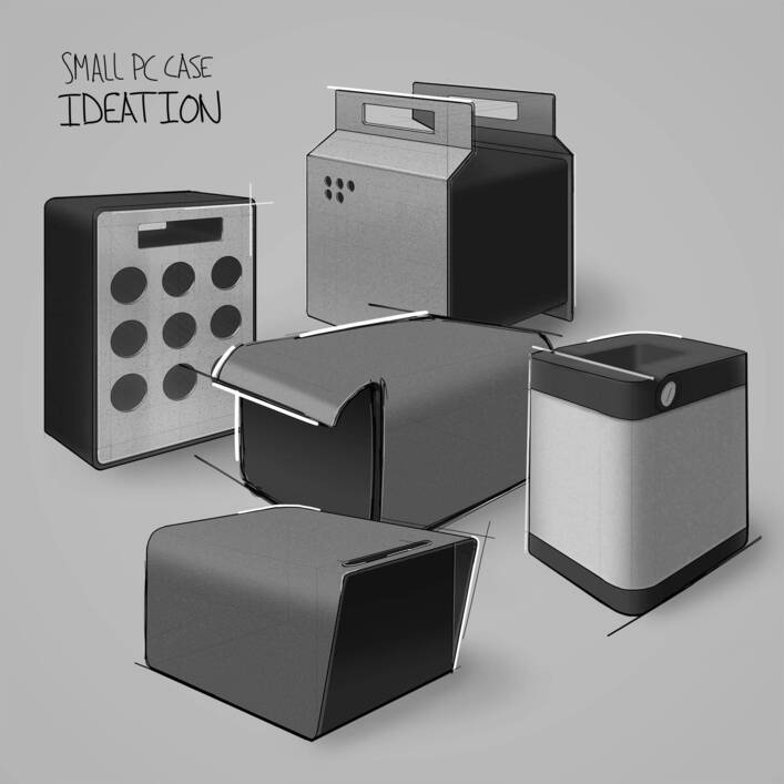

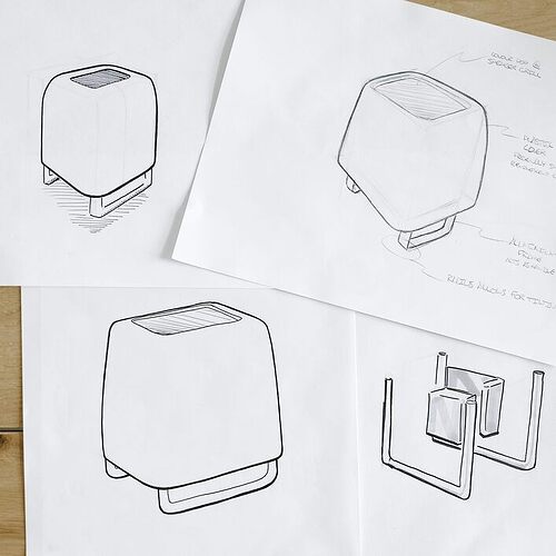

Alright, enough talking, now let’s get to the sketching. I narrowed down my initial ideas down to this one board. So I looked into how the components would be layed out for the best use of space and best potential for cooling. Then, I looked at how the end-user would get to build their machine. Finally I made these possible uses of those configurations as a first draft that follow the aesthetics and materials I’ve mentioned previously.
  • Left Most this case would be quite flat. The components would screw into a large plastic main component. Then an aluminium panel would slide over top to close everything off. To get the flat layout, a PCI expansion cable would be required (possibly expensive) to get the GPU flat next to the motherboard. This also means the I/O would be on the side of the case which would be very visible. Cooling is a bit of an unknown. Air would be drawn through the aluminium panel and through both the CPU and GPU coolers. I’m wondering if an accessory fan would be required to properly evacuate the warm air so it doesn’t recirculate in the heatsinks. On the plus side, it would be a simple case to fabricate, barring the large plastic component. It would be easy for the end user to build into as everything is flat.
  • Top Center This one looks a bit like a a milk carton. My sketch is a bit out of proportion, hopefully it could be made a bit smaller. The components would be arranged as in a standard tower case or possibly in a flat arrangement as above. I’m not sure how usable those top handles would be. This concept could be modified by removing the handles from the panels and have a panel with a nylon strap attached to it and the other one just acting as a grill. The components would get attached to a central plastic loop which would make it quite easy to assemble as you could access to sides.
  • Center and bottom Very similar ideas. A cube that’s broken into halves. One bottom plastic part which holds the components and a panel that slides over top that has a handle. While certainly functional, this is more inline with existing products and may not stand out as much
  • Right Most This one is very inspired by the G4 cube. the body is built onto a central frame and the paneling slides over it. The air flow would go from bottom to top
So I’m thinking my next step is to wrap up a roster of potential configurations and start investigating them more seriously. I really want to figure out the pros and cons by looking at the compatibility with components, ease of assembly and thermal implications.
The idea of a fabric loop would change a lot of these initial concepts and makes a lot of sense the more I think of it. A lot of volume is used up by handles in these sketches which wouldn’t be required with a fabric loop.
As always, comments and feedback is welcome! As much about the project on my sketching. I haven’t been sketching for long and haven’t had formal training. For one, I know I really need to loosen up. Something this early in a project shouldn’t be taking even half as long as this did :laughing:

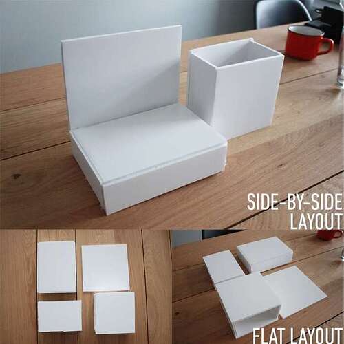

To test out different configurations. I made rough foam core models of the core components of the PC. After seeing the overall envelope that would be required for different configurations, I’ve settled on a side-by-side configuration that seems to be very well regarded on the Ncase M1.
This configuration allows for a good balance of the aforementionned criteria. It may not be the smallest but it should be quite easy to build in and work well with a wide variety of components.

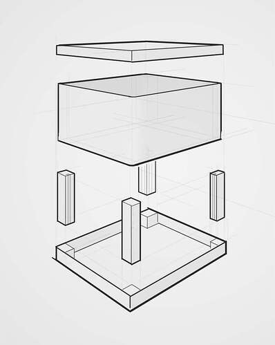

One way to use the mix of material would be a sturdy plastic base, internal plastic columns that would act as T-slots where the PC components could be attached. An aluminium sleeve could provide covering and structure to the internal and have a sturdy plastic part on top to close everything up.

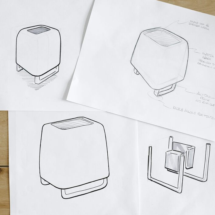

So back on the case. The issue I was mentioning last time was with the location of the IO port and keeping the cables tidy. My initial solution at the time was just to adapt the direction I was already taking. However, after putting things back into perspective, I’ve came up with a new and quite different direction that still follows my initial brief.

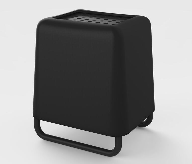

The concept revolves around a bent tubing frame with a plastic shell that slides on top. I flipped the computer entirely. The cables and IO would now be at the bottom of the case. Automatically hiding the clutter. The bent frame can act as a pivot when tilting the computer to access the IO. It can also be used as a handle when moving the computer around.
The large plastic shell has a bit of an Eames chair feel to it which I like as it makes it feel like a more home product than strictly cold electronics.
I also threw together a quick draft 3D model together to get a feel for proportions. There’s obviously still a lot to work required there.
This is where I stand. I’m not sure what to do at this point. I have two very different directions that seem to have merit but I need to pick one. :confused: I’m leaning towards this latest concept at the moment because it has a distinguishing look and feel and would have the potential to be very cost effective.
You guys have also been quiet for the last little while :wink: . I’d really like to hear you out at this point more than any other on your thoughts about the directions I’m looking at and the project in general.
