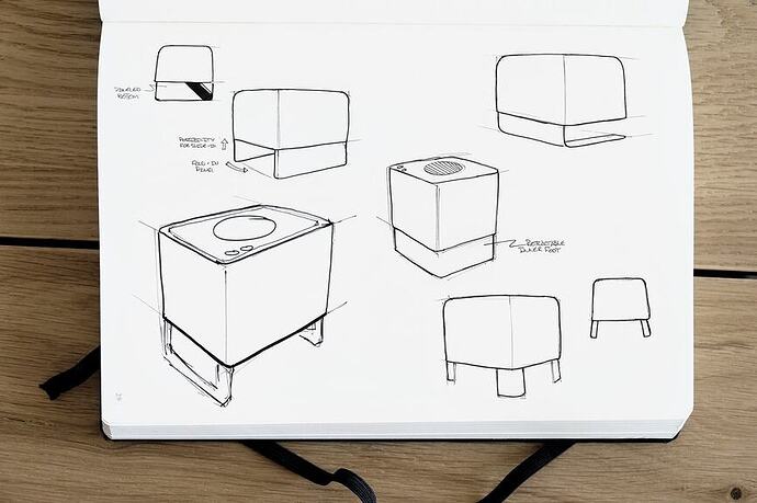

I’m glad I’ve finally settled on a form but I couldn’t resist doubting it…

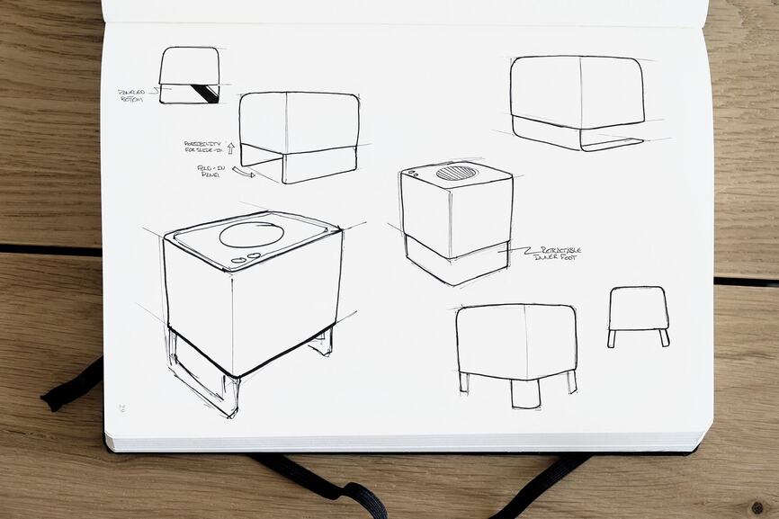

One thing I was wondering is the practicality and use of those bottom pipe. There’s a familiarity to them but the angle in them keeps them from being retractable. If part of the appeal of this case is portability, it seems a bit odd to have those big pipes sticking out the bottom.
So I had a look at different ideas for ways to lift the bottom of the case yet be retractable. I ended up not too far from where I started :laughing: just making the pipes straight would allow them to be retractable or removable. Having right angles would also allow the case to be laid on its side. Much more practical!

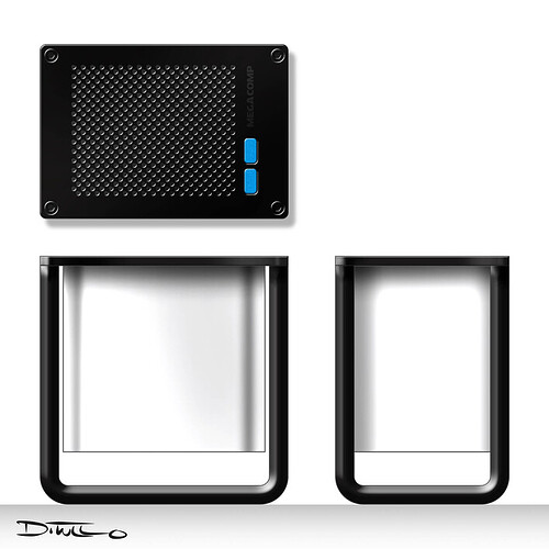

Here is an alternate construction for you. I sketched it up real quick, happy to send you the vector file if it helps.
So my iteration is to have the bent tubes go all the way up to the top plate. The top plate could be a thick piece of billet aluminum. add threaded inserts in the tubes and have exposed hex fasteners counter sunk in. to the top plate. Machine out the offset perf, celebrate the buttons a bit more, and give it a name which you could etch in to diet vinyl letter. Then moon the actual CPU case to the underside of the top plate, letting it suspend downward. The bottom could be open or pared metal for ventilation.
The top view got messed up when I scaled it, should be more like this.
[ Deleted ]
I realized I messed up the side view… fixing it lead to another iteration. Solid aluminum top panel that is clear anodized. Generous radii in the top view concentric with bent powder coated legs. Maybe I’ll render it tomorrow.

Thanks for putting together those drawings :slight_smile: . Having the tubes on the outside could be taken even further by thinking of it as an exoskeleton with the guts in the middle. Part of my rationale for the tubes was to have them act as a frame for the internals. On the inside, flat panels would be bolted in between the tubes and act as a mounting surface for the internals. That would make the installation easy as there wouldn’t be much in the way. It also keeps the part count and overall volume down.
I like having the top plate flush with the top of the computer. I had initially made the plastic part come over the top plate to act as a bit of protection for the buttons when traveling. Also, when moving my computer around say from my desk to my living room TV, I find I don’t have a good place to put my peripherals like my mouse - maybe that lip could act as a little receptacle when moving things around. Having the buttons flush with the top plate would allow for the cleaner look and remove the lip. I’ll give that a shot!

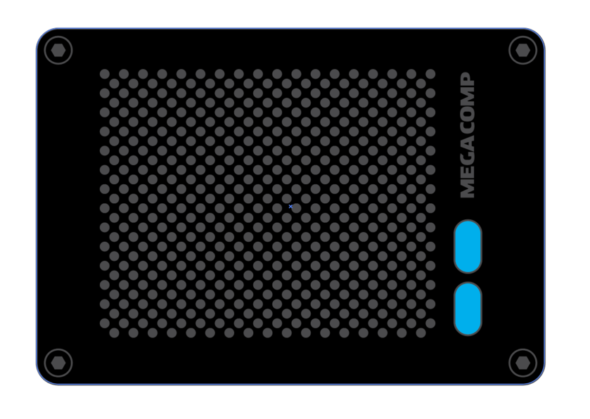

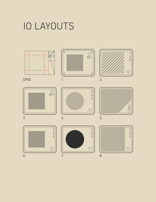

Alright, I’ve managed to go through some IO panel designs. Quite a few crazier ideas didn’t make the final cut shown in the following picture. Based on the internal layout of the machine, the fan will need to be offset. For that reason, most of the designs that looked good started by breaking the rectangular top into a square for vents and have a slim rectangle on the side for IO.
For the button, I’m considering a fairly large single round button. It doesn’t seem like the reset button is used anymore on computers. A long press of the power button does the job. I’m also considering a sliding switch(think iOS setting sliding switch). Usually sliding switches are used as toggles, either set one way or another, to denote a setting selection. However, it could be an interesting gesture as a momentary switch. So you’d slide it over and by bringing it to the end of its throw and then it would spring back as you release it.
Most of the designs are quite self-explanatory: vent holes, power button, USB ports and audio IO. For #7 I was considering putting cloth grill over the fan. Though that may tie the design to black as a cloth any other colour would dirty very quickly. Concept #1 was considering some bolts to hold the panel onto the frame. I let those out afterwards as I think I’d favour having the lip of the plastic section push down on the panel and have no visible fasteners.
I’m personally really digging #8 and it seems to suit the rest of the case quite nicely. Having two distinct sections is reminiscent of the case a whole - the open legs and the solid top section. The vents are a bit more subtle in their function that the other designs and could possibly allow for more mounting options like different fan sizes and even moving the fan to fit different components. The IO is well aerated and the blank space between the ports and the button could be used for branding.
The actual size of the vent holes will need to be worked on I think their too small right now.
I think 5 and 8 are working best. Try an island within the perf as well.
Great thought process here!
Great work Louis! #5 is by far my favorite, followed by #2 and #8. The latter two being very Dieter Rams.
As you mentioned, the size of the holes/slots will be very important. To ‘transparent’, seeing too much of the inside, will likely not add the visual perception of the computer case. I’d advise you to test a couple of options once you get to the prototype phase. Looking forward to your next post!
Hmm, that would be cool. The sliding I was thinking of was just to retract the bottom pipes. Having handles reveal themselves would be cool. A really nice mechanism would make this really fun to use.
My use case right now is that you tilt the computer down to unplug the cabling. From there, it’s quite easy to lift it from the handles that are usually at the bottom.

It seems like a fairly tight perforated pattern throughout the top is a winner, I’ll have a look at what else I could do in that direction…
Thank you, kind sir! :slight_smile:
I actually started off in a very Dieter Rams direction with #3 and #6. Going with the non-offset perforations to act as a geometric feature rather than a uniform backdrop. Sort of like this sucker:
I actually tried the typical offset hole grid which provides more airflow but it wasn’t doing much as far as styling goes.
Agreed as far as hole sizing. Seeing too much of the insides will wreck the look. I think thickness of the top plate will be one of the driving factors. A thicker plate will hide the inside at more viewing angles.
