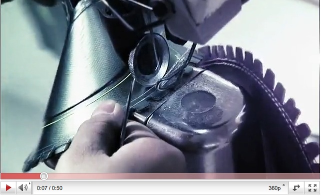

Pardon my ignorance…is that a high-end soccer ‘boot’? I gather most athletic shoes aren’t made in that way?
It may be a higher end boot, but the construction and manufacturing is totally standard for pretty much any athletic shoe. Was there a particular part/process you were wondering about?
The mix of hand-work and robotic/factory tooling was what I was curious about. There’s a part at about :14 with some kind of bladder machine, followed by some hammering on the bottom - what’s going on there, sort of stretching the upper around the mid-sole?
Its a pretty neat process, of which I’m not familiar - wouldn’t want to be banging out a quota of those every day though!
What you mention is the lasting process. The bladder thing is forming the heel counter. The following machines are for lasting, first showing the heel lasting, then the toe lasting (both likely using a process that injects a type of glue to hold it together). Then the waist lasting, by hand.
Really, there is nothing “robotic” per se. All the machines are operated by a human operator who puts the shoe (on the last) into the machine then presses “go”.

PS. FWIW, a typical production line can produce about 2000prs per day. Of course each person is doing just one operation, and there might be more than 100 people involved to make a single pair (counting all the steps from material cutting to stitching, lasting, assembly ,etc).
Stitching around the lasting margin

If I’ve got anything wrong, feel free to let me know. I haven’t actually even seen the boot, BTW, but have seen the process countless times…
