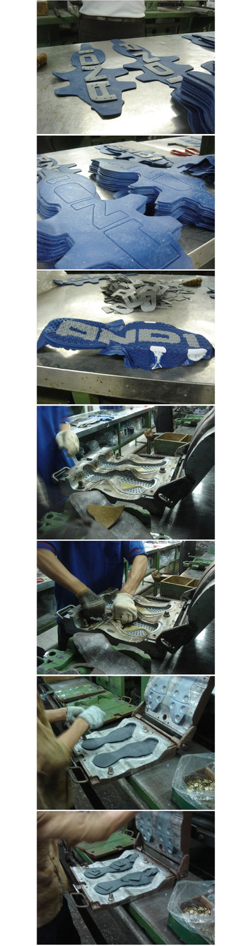

i do have a large question though, where did the soles come from? ive noticed that the new balance soles are usually multiple colors, how is this done?
Is it done like plastics with multi-injection molding? any help would be great.

They are pressure molded rubber outsoles. They are probably made in a different part of the factory or shipped in from another local factory. I’ll try to find you a video (or pictures)of this process.

Here’s some pics of the process.
Essentially it’s a big, heated metal mold that die cut pieces of rubber are placed into, by hand, then closed and put under pressure for a set time.
Colors in different areas are done by a multi-step process, first putting in one color, pressing it, then cleaning the excess around the colordam with a knife, then putting another piece in, repeat.
