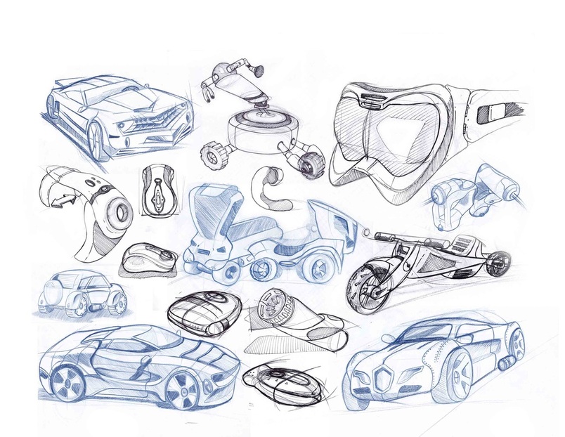

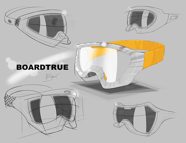

Below are some goggle sketches and a quick concept render of one of the forms. Trying to improve proportions, line control and capture a looser style.
Any and all feedback is helpful!
