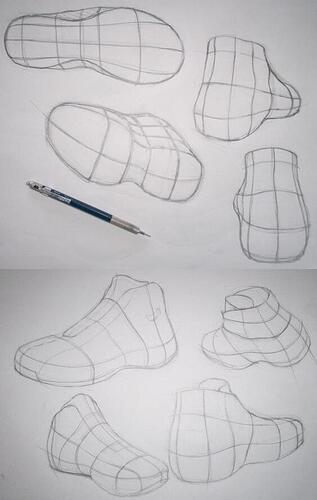

Hey R,
I agree with you on the fact that the computer and rendering is nothing but a tool and for a designer that says hmmm. I have never drawn anything in my life but I want to render, he needs to get control of his pencil skills and translating 3D objects to a 2D surface.
I have been drawing my whole life and I an very confident with my pencil skills. With that being said, do I have the technique and style of an accomplished iD guru? Nope. Can I translate a thought on to paper with a pencil including shading and a sense of proportion and attachment to the real world, I would have to say yes.
More pencil time is not what I need for furthering my ability to stay interested in designing sneakers. The proportion will come as it has from when I started posting here.
I have a really good control over vector manipulation but when it comes to adding color and presenting a design with computer aided tools I suck and that has nothing to do with my ability to draw freehand.
I will post some pencil images and you can tell me how more time will aide me in learning how to render a sneaker or better display an idea I have.
I am very interested in your response and I look forward to reading it.

I do realize that you already draw. I’ve been following the threads, and see you have good fundamental base and certainly are eager.
My comment is more to effect that as you mentioned, computers are a tool. I think you would improve much faster and be more prepared to render with more proficient sketching.
You have been improving greatly in your footwear drawings, but there is still room to go. You have lots of time to learn how to render later, and im sure school will also help with rendering techniques.
Take a look at some of the other footwear portfolios online, such as Yo’s -
Lots of footwear design is still done by hand, and it would help first to develop those skills. As mentioned, improving perspective, proportion, etc. go a long way.
For example, look at your image below-
its a pretty basic form (boxes/rectangles), but the perspective is really skewed. Not the box in the front has diverging instead of converging lines that dont follow a true perspective/vanishing point.
Your work so far is OK, but there is still room to improve. I’d also suggest further developing your aesthetic/design sense in terms of pattern, forms and shapes. Learn the conventions of different types of patterns for different types of shoes (ie. typical running toecaps, basketball collarlines, lacing options, etc.)
As an exercise, (i think someone else mentioned it as well), draw a real shoe (sitting on the table in front of you, not from a photo). Do side views, top views and a perspective view. Get control of your line thickness, and making 3d forms in 2d drawings (ie. making a side view look 3d not flat).
Then move onto to your own designs, developing iterations of one concept to refine and improve it, finally looking at detail, colors, etc.
Going straight to rendering//computers now will not help develop these things.
Please understand I’m only trying to help here, not at all putting down your skills or where you are at.

First of all Thank you for taking your time and posting your input and by no means do I take any of this personally, this is why I’m here :wink:
Based on your response and references it makes total sense and I agree.
This is the purpose of this thread. I have no problem putting myself out there as it unfolds in real time.
Prior to this I didn’t understand your point.
I’m naive and I have no experience in this industry but I am very willing to learn.
Being a fellow that owns one pair of sneakers (hey I like Hush Puppies) I think a trip to the local shoe shop is in order to get some permission to do some quick draw studies.
As you say, I have no clue as to toe shapes and etc. I’ll make it a point to spend the majority of my time drawing real shoes.
At the same time it’s important to me to start the learning programs of Photoshopcs3 and Illustratorcs3 and I might as well use shoes as my point of interest.
Thanks a bunch for your explicit and open reply, I look forward to your input as time goes on

I decided to concentrate on items of the shoe for now then when I get the hang of things I will incorporate more of the shoe.
By the way, the medial and lateral side are asymmetrical due to the asymmetrical location of the protruding ankle bones.
