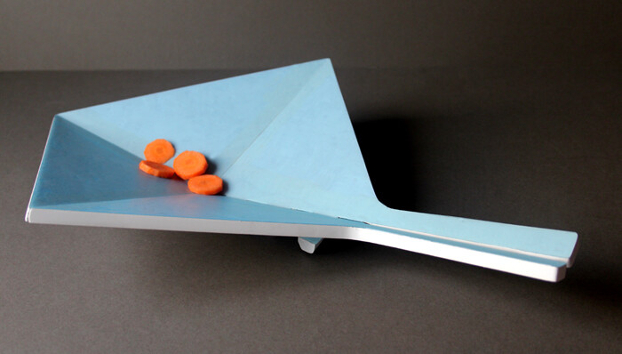

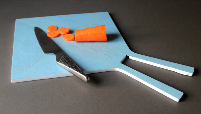

and a chopping board that transforms into a bowl and back again (also can’t embed this video: chopping board design - product tank - YouTube
Fun stuff. Especially the mug. I think that is pretty useful. There is a similar cutting board from Joseph Joseph you might want to look into. I don’t totally understand the pan lid, but would like to see more. Can you show us some more angles and process?
Hi Yo - I’ve seen the Joseph and Joseph chopping board and was trying to better it. Their’s doesn’t maintain its shape in it’s folded position without keeping a grip of the handle and you also have to tip the contents out of the end opposite the handle, which I don’t think is as ergonomically comfortable as tipping it from the side as with mine. That said, the Joseph and Joseph versions folding handle is easier to actuate where as with my prototype there is a bit of a hand stretch, so what I gain on the one hand you could argue I loose on the other.

The chopping board prototype is plywood, sprayed with primer, then the top is covered in double sided carpet tape to create the hinge and then finished with a sheet of polyprop. This would also ideally be one piece in production.

The cutting board is a cool idea too, though it reminds me of those flexible cutting boards that you’re supposed to bend easily for funneling purposes. We got one and the funneling didn’t work as well as I liked (things stuck to it) and it wasn’t durable at all. What could be fun with yours is to have a few and have each turn into a prep bowl to stage ingredients it.
