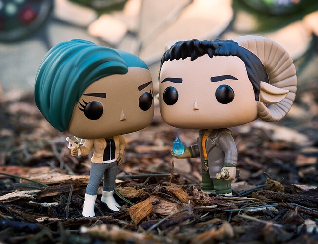

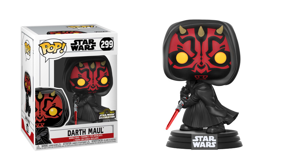

I hadn’t looked into ZBrush as I had thought of it as a tool for animators/screen output, but perhaps that would be a good option. Reading in the GeekWire article that Funko Pops use it is certainly an endorsement.
