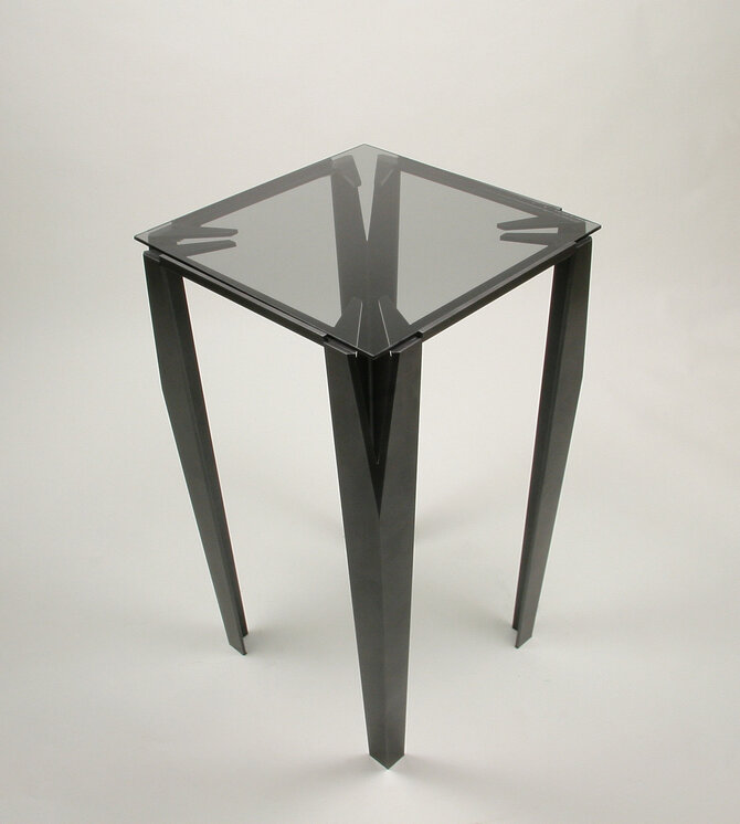

Yeah the fasteners I’d rather change out for something that was countersunk with a flat head.
I was going to use the chair as a study of ‘prosthesis’, where I would take the steel form and fabricate 5-7 different versions for different occasions, tasks or interactions. Possibly even vary the material, who knows yet.
I’m not really getting the metal slot description, but a sketch would be awesome!

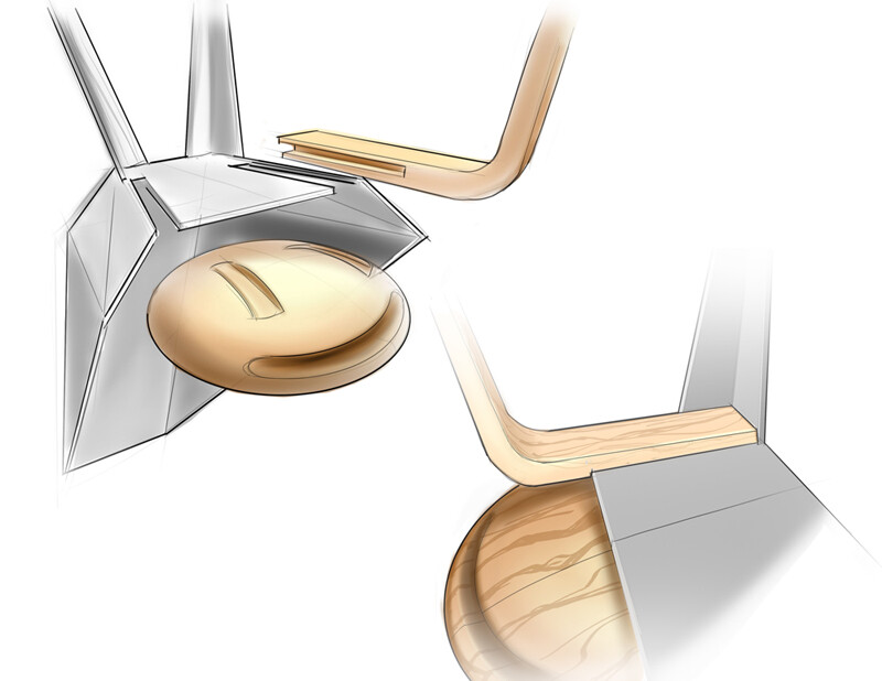

so basically the slot detail in the bottom of the wood disc would have a slight dovetail or other key or dado type detail to accept the leg, with a slot in the leg that would allow the leg to slide into the disc and the metal back this could have a friction fit, some type of detint, dowel faster. or large countersunk philips head.
Great sketch! I might be worried about the stress riser created on the inside of the dovetail when you sit down. It could eventually split, but definitely worth testing. The aesthetic is brilliant though and makes perfect sense, thanks!
That is one of the most awesome posts ever! I love it when we get technical on the nitty gritty!
Yes, great sketch BTW!

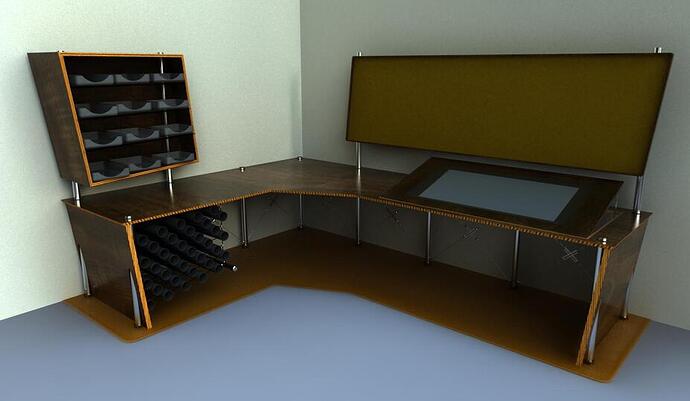

Architect’s workstation (commissioned work)

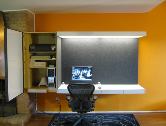

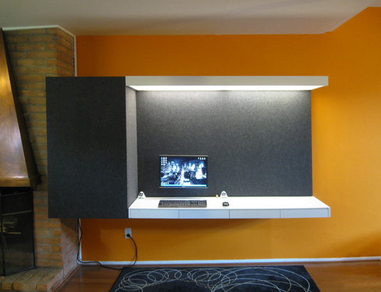

Work Unit A wall mounted workstation for myself. Desk, light, pinup, cabinet and marker board
Pretty sweet setup splishsplash
my only crits would be (and I’m being VERY critical as this is pretty awesome)
1 - right next to the fireplace ?
2 - if I went through that much trouble to make such a nice thing and wall mount it,
I would install a new outlet through the cabinet in some way to power the whole unit
instead of having the one plug dangling (could be MUCH worse, don’t get me wrong)
Is there a gutter or cable dump or anything at the back of the worksurface?
Any other power access from the work surface?

Thanks IDiot!
Good points…
  1. my place is small, strategically it’s the best place for me, also, I really never use the fireplace.
  2. i’m a chicken with wiring. the light is internally wired, but, i was afraid to mess with electricity in my place.

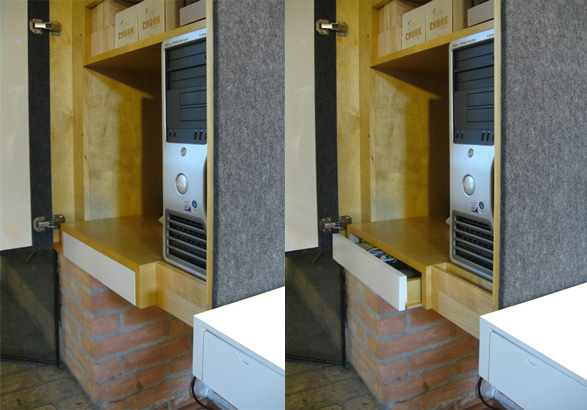

Oh yes, there is a “gutter” wiring in back, I think the picture explains it better.
Where the desk meets the cabinet, at the end of the gutter, there is a hole in the cabinet so i can
access more power. I’m messy enough as it is, so wanted no wires showing. Computer location allows
me quick access to usb.
Thanks for the comments!
a couple more shots…

ahhh markerboard on the inside of the cabinet, that is pretty AWESOME for a home office, open it to work, close it and it disappears, very nice.
