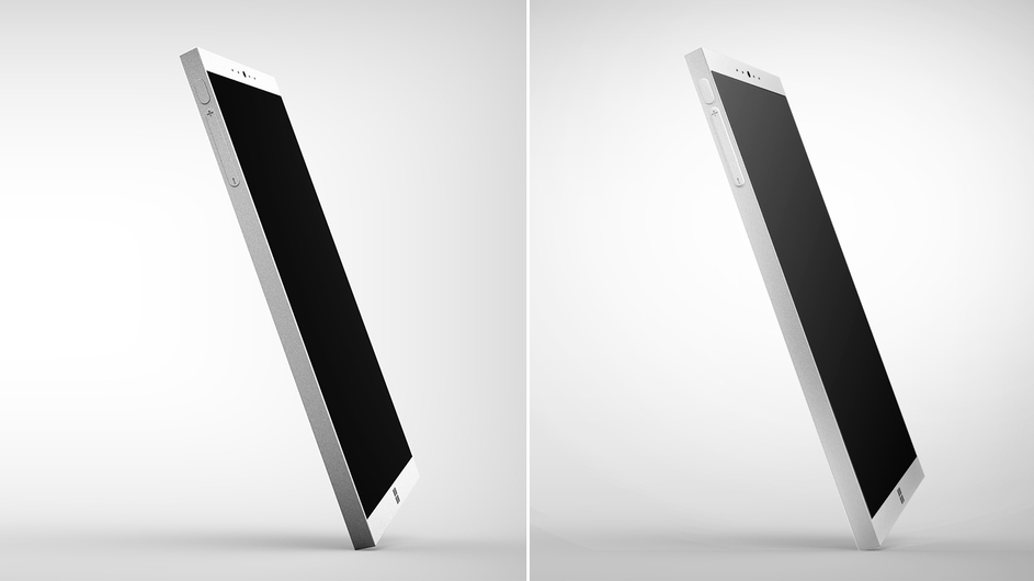

This was a fun personal project I completed in a couple months, throwing an hour or two at it per day that really caught traction with Microsoft and tech enthusiasts. It was the #1 trending article on WindowsCentral for a few days, creating 6000+ hits in less than four hours. My point is, there is a definite interest in a Surface Phone, but what it’s going to focus on and what it’s going to do is in the air.
I pulled a few trends and technologies that exist currently, but aren’t quite there yet in terms of mainstream-readiness to develop the unique functions of this device. In terms of design, I thought through and sketched out a lot of different ideas, but something about Microsoft’s design values of simple & pure, and the idea of distilling seemingly powerful functions of the Surface lineup into simple forms made me come up with the pureness of form for the phone. The camera bump is how I imagine, realistically, what would be required to fit such powerful tech into a device.

It feels very derivative, there are lots of good ideas but they’re all pulled from other products like Google Tango, Samsung Dex, etc. There are already devices with depth cameras built in for an example of form factor https://get.google.com/tango/
As a pure sculptural/ID exercise it feels under developed, a bit like the almost pure rectangle nextbit Robin phone (https://www.nextbit.com/) but without some of the playful elements. It feels sharp and cold in an era where most manufacturers are moving towards rounding everything (the UI, the screen, the phone itself).
Details like the cover which just comes off as a pure white brick without material…rather than seeming soft and protective it just comes off as a brittle block of plastic, the design aesthetic doesn’t seem to match it’s function (compared to most smart covers which are soft, felt, padded, etc). Theres also no indication of how the kickstand mechanism would work. Most phone/tablet cases that use that type of folding feature use the case itself to act as the kickstand, since the hinge needs to be curved to open.
Your presentation is well done, and all this tech is basically feasible today. But you come at it from an approach of “Combine all this tech into a singular product” and it seems to take away from who the ideal user of this phone might be. Just for the uber designer/engineering professional? Your grandma? The instagram trendsetter?

The corners look like they’re gonna wear through my jeans pockets real quick.
Why wasn’t the form inspired by existing Surface products, to fit in with the brand language?

The project is well presented, but I’ve hesitated to weigh in because I feel like it doesn’t push any boundaries. Before you read any of this, please know that I respect the amount of work you did here. The quality of execution is very high. What I’m going to be critiquing here digs down a layer below the execution, below the features, and in some cases below the core idea to why would Microsoft make this and why would it be successful as a tool for an average citizen.
Presentation: feels very Apple. Is that what the Microsoft brand is? I think the brand deserves a unique POV, and with this level of execution, that core POV should inform everything down to the visual communication strategy. Don’t think of it as style, think of it as a way of further communicating the core idea.
IxD: In terms of interactions, it is a nice collection of pre-existing thoughts wrapped up into one device, but I can’t help but think “what else”. Is this really pushing the boundaries of what the mobile device can do for the average citizen? All that advanced tech and we are seeing current windows mobile tiles? I think the ecosystem of a user’s devices and the the peer to peer ecosystem of the many could be pushed a bit more.
Industrial Design: It is nice, well executed, but expected. It feels a bit like an iPhone that got pulled out of the CNC before it started machining the radii. Is this honestly better than some of the Nokia Lumia Windows Mobile phones? (some of the best ID in mobile phones ever and made from much more mobile appropriate materials). There is so much tech in the camera array but it feels like an engineering appendage vs a design statement. You should be doing the ID for the ecosystem at this level. Stylus, tablet, HoloLens, the whole system, in my opinion. Renders are a little low res.

To be blunt, the design of mobile devices is incredibly limited these days. The front is glass and 95% screen, the button placement has been dictated by years of legacy (and the couple of people who’ve tried distinct and new things like buttons on the back have usually eaten dirt because of it). The sides are only a couple MM thin so you’re very limited.
Samsung’s main innovation was actually getting the screen to take on some new shape, which leads to an interesting design and improves the feeling in the hand, but has limited novelty outside of that.
It’s a very stagnant industry because of that, and it means there are simply very limited design opportunities, even for professionals.
If you purely wanted to improve this presentation, I’d consider polishing up some of the renders, add some materials for things like the case so they feel more thought out. But as an overall design exercise mobile devices are incredibly hard, don’t take it as a strike against your work.

Thank you so much for the honest critique, especially in terms of IxD and Industrial Design. I can see what you mean about pushing boundaries and really trying to create a statement. It’s a concept project, after all. My goal for this project was to remain grounded and create an understatedly clever product that people would think of as cool & seemingly viable. But you know what? I’m going to take your advice and really push boundaries for my next concept presentation me (and a team now!) are working on. I really appreciate your last paragraph. I had a bad habit in school of being defensive in critiques, and sometimes I still feel defensive. I’m so passionate about my work and love design. I’ve really lost the ego since graduation and really working to learn from others because being passionate and having an overly-inflated ego shouldn’t co-exist.

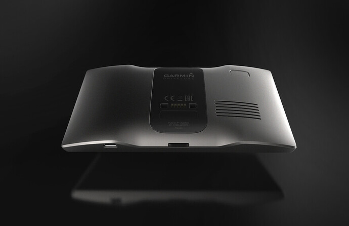

Just going to throw this into the mix regarding smartphone ID… this is a GPS, but still, 95% screen on the front, thin edge, blank back. This is pretty well done, in my opinion: Behance
