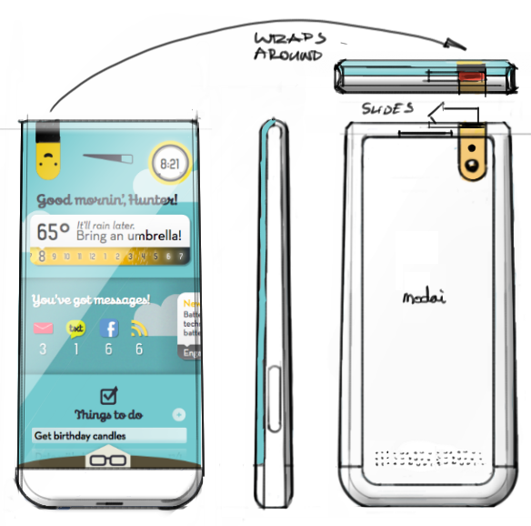

Some quick shots of the development of the UI. Not much words now (if you’ve been following you should know what’s going on though), but will have a full writeup when I finish the first iteration.
UI (just the top portion)

The ID is really coming along now.
My thoughts:
Really liking the simplicity of the first blue one, it relates to the little UI characters without being obvious.
Orange one: feels very average and unemotional
Watermelon: fun, poppy, while being hyper normal, this one works very well, but it will all be in the details and execution here.
Banana: simple tweak to the front view is nice. Asymmetrical bump might not be good for pocket and lefty/righty switching?
ModaiX: feels very Yyves Behar
4 Bumps: there is something here worth developing
Modai Skin: love the use of the UI character in the physical design, rest is too iPhone
Dog Ear and Panda Rams feel very 1980’s Sony.
I would further develop:
The blue one: most formy, maybe integrate character from Skin concept
Watermelon: most Bauhaus
4 Bumps: Most customizable with texture, color, and material
I think that would give you a nice variety to choose from

Just a quick shot at what I’m sketching up right now. Detailing some camera button. Really liking the “pimple” hill on the bottom right.
go to sleep kid, it is past 1am East Coast time! More to do tomorrow! :wink:
Great work with some very nice ideas and execution! My only advice would be to try to clarify and simplify the overall concept. If it’s about ‘humanizing’, what does that really mean? I like the little character that charges up when cord is attached, or the speaker level changing by ‘opening/closing’ character’s mouth. It’s ‘cute’ and has personality… But are those really what strengthens your concept of ‘humanizing.’? How is shown in the industrial design/form/materials/details?
I’d try to dig deeper into who this is for…Maybe it’s targeted toward a certain type of consumer? Or certain types of consumer behavior? (ie sleeping with their phone on their bed, playing with phone antenna…etc)
A simple concept with a clear point-of-view can go a long way over another concept with too many ideas stuck together without a clear cohesive vision. When I was a student, I used to do projects like the latter; and realized that I don’t have to use up all those great little ideas on this project I’m working on now. It’ll come back to you later.
Hope that helps :slight_smile:
