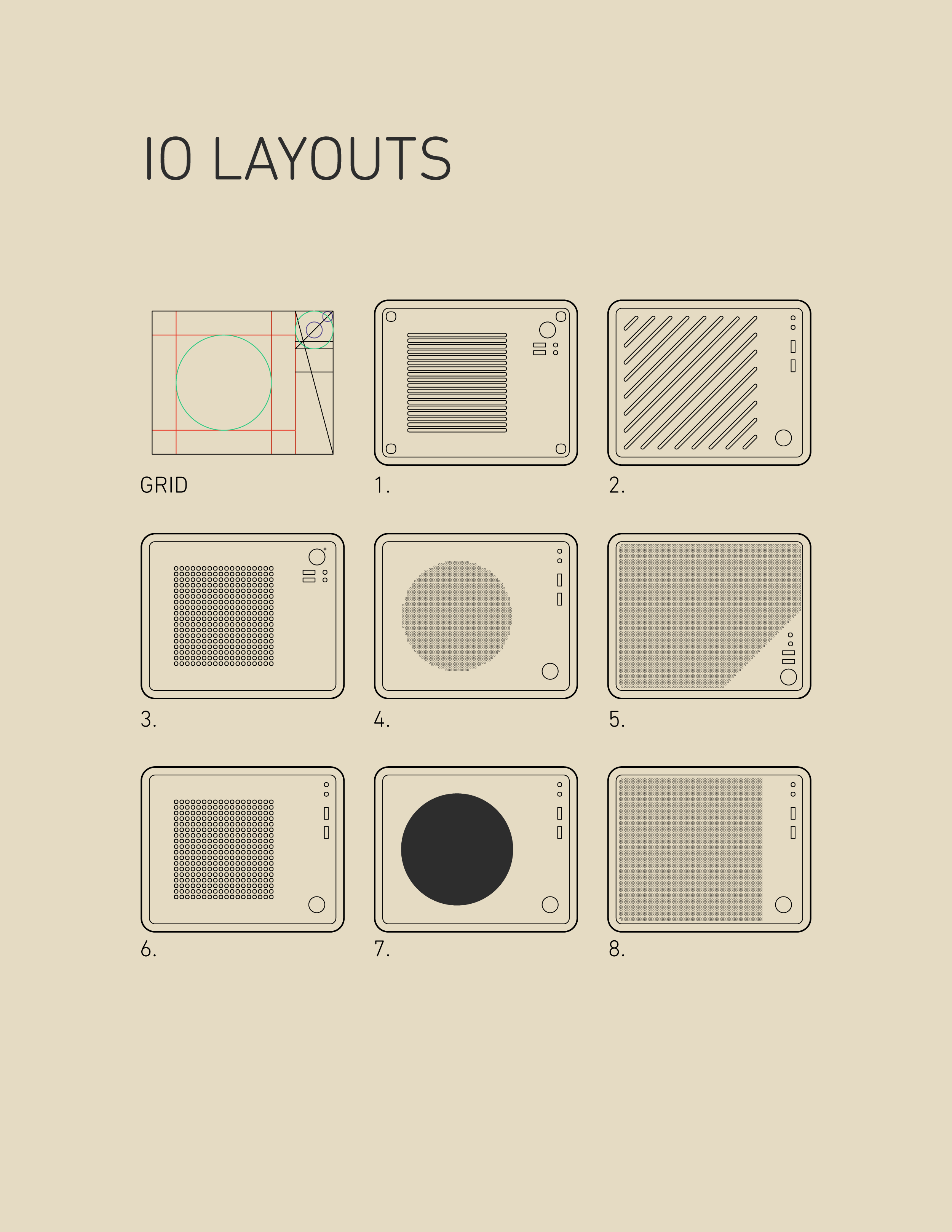

by louis leblanc
Alright, I've managed to go through some IO panel designs. Quite a few crazier ideas didn't make the final cut shown in the following picture. Based on the internal layout of the machine, the fan will need to be offset. For that reason, most of the designs that looked good started by breaking the rectangular top into a square for vents and have a slim rectangle on the side for IO.
For the button, I'm considering a fairly large single round button. It doesn't seem like the reset button is used anymore on computers. A long press of the power button does the job. I'm also considering a sliding switch(think iOS setting sliding switch). Usually sliding switches are used as toggles, either set one way or another, to denote a setting selection. However, it could be an interesting gesture as a momentary switch. So you'd slide it over and by bringing it to the end of its throw and then it would spring back as you release it.
Most of the designs are quite self-explanatory: vent holes, power button, USB ports and audio IO. For #7 I was considering putting cloth grill over the fan. Though that may tie the design to black as a cloth any other colour would dirty very quickly. Concept #1 was considering some bolts to hold the panel onto the frame. I let those out afterwards as I think I'd favour having the lip of the plastic section push down on the panel and have no visible fasteners.
I'm personally really digging #8 and it seems to suit the rest of the case quite nicely. Having two distinct sections is reminiscent of the case a whole - the open legs and the solid top section. The vents are a bit more subtle in their function that the other designs and could possibly allow for more mounting options like different fan sizes and even moving the fan to fit different components. The IO is well aerated and the blank space between the ports and the button could be used for branding.
The actual size of the vent holes will need to be worked on I think their too small right now.
Re: Computer Case
Posted: October 2nd, 2016, 9:33 pm
by yo
I think 5 and 8 are working best. Try an island within the perf as well.

Re: Computer Case
Posted: October 3rd, 2016, 9:16 pm
by holtag
Great work Louis! #5 is by far my favorite, followed by #2 and #8. The latter two being very Dieter Rams.
As you mentioned, the size of the holes/slots will be very important. To 'transparent', seeing too much of the inside, will likely not add the visual perception of the computer case. I'd advise you to test a couple of options once you get to the prototype phase. Looking forward to your next post!
Re: Computer Case
Posted: October 4th, 2016, 9:01 pm
by louis leblanc
KenoLeon wrote:
louis leblanc wrote: I'm not sure I totally understand your idea or how you'd implement it.
I thought about a couple of ways, hopefully this makes it a little clearer :
Hmm, that would be cool. The sliding I was thinking of was just to retract the bottom pipes. Having handles reveal themselves would be cool. A really nice mechanism would make this really fun to use.
My use case right now is that you tilt the computer down to unplug the cabling. From there, it's quite easy to lift it from the handles that are usually at the bottom.
Thanks for taking the time to sketch! :D
yo wrote:I think 5 and 8 are working best. Try an island within the perf as well.
Something kind of like this?
It seems like a fairly tight perforated pattern throughout the top is a winner, I'll have a look at what else I could do in that direction...
sachin wrote:Great thought process here!
Thank you, kind sir! :)
holtag wrote:Great work Louis! #5 is by far my favorite, followed by #2 and #8. The latter two being very Dieter Rams.
I actually started off in a very Dieter Rams direction with #3 and #6. Going with the non-offset perforations to act as a geometric feature rather than a uniform backdrop. Sort of like this sucker:
I actually tried the typical offset hole grid which provides more airflow but it wasn't doing much as far as styling goes.
Agreed as far as hole sizing. Seeing too much of the insides will wreck the look. I think thickness of the top plate will be one of the driving factors. A thicker plate will hide the inside at more viewing angles.
