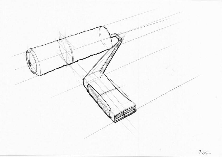

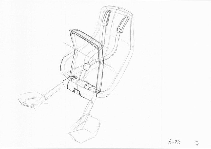

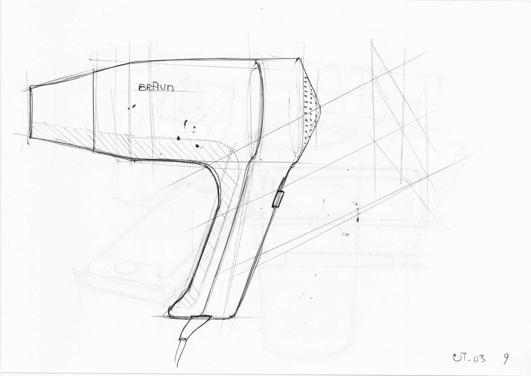

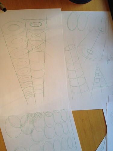

nico. Great start.
I’m reasonably sure your ideas didn’t just pop out of your head directly into CAD. Do you have any hand drawn “process” sketches you can throw in? CAD is important but as a developer of ideas an industrial designer needs to be able to quickly capture thoughts with sketches and shows a prospective employer a lot about your methodology. Coffee stains and yellow ruled paper are acceptable
