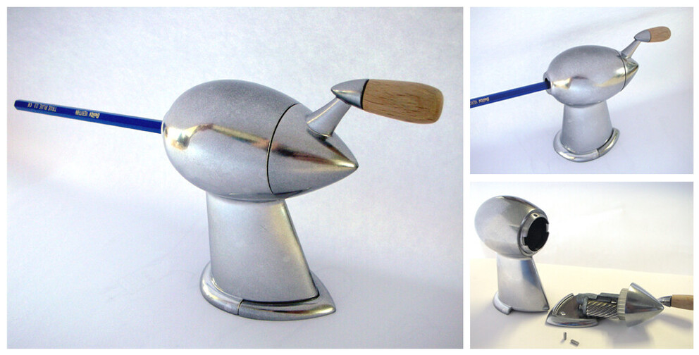

I couldn’t resist resurrecting a design icon. Ahh, the joys of Solidworks and rapid prototyping. Too nerdy?!

What parts are rapid prototyped? What kind of process? The cutter could not be RP, existing cutters and gears?
Yep, off-the-shelf cutter and cutter holder. SLA’ed drive gear (inside the handle) and body - then a turned wooden handle and a couple of threaded inserts. Then it’s all hand finished, enamelled and coated in Alclad chrome paint - it’d be nice to do an investment cast version, but by the time I’ve gone to those lengths, I could have started a production run :wink:
