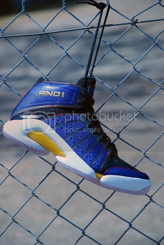

I know in many of the upcoming/current And 1 shoes, you see a segmented outsole that allows for three intrinsic points of contact at any given time (making the shoe much lower), but I can’t necessarily assimilate the importance of a segmented forefoot.

In the case of the And 1 shoe, the segmentation doesn’t make the shoe any lower. To make the shoe lower you simple take out cushioning, there is no other way to do it.

Yo, I appreciate the correction on my post. I have played in a couple of shoes with the exact same outsole configuration, and all have seemed lower than several of the shoes I’ve played in. In talking with the designer, I found the segments are actually anatomical flex zones, which may have led to my initial premonitions. In looking back, Free seems to have been the first series of shoe were I noticed the outsole segmentation for natural foot movement.

Ruchinsky: The And 1 shoes are called the Onslaught and I think they’re scheduled for an August/September release, but I’m not sure. That particular model was a special makeup for the opening of Solebar L.A. on 7-7-07.

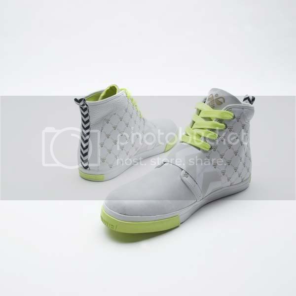

What are these?! I really dig 'em. I’m running a bit low on funds now, but if you have a size 13 available, or a place online where I can grab a pair, let me know.

glad you like. Those were from FW06, and pretty limited distribution so im not sure if you can get them anymore. if you like, you can try contacting someone at hummel head office. contact numbers/info are at www.hummel.dk
