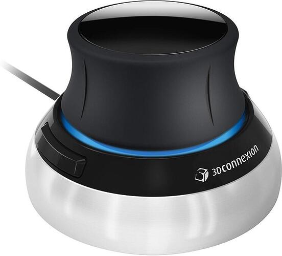

I use a 3DConnexion SpaceExplorer for CAD. Saves the panning and zooming for the non-dominant hand. Helps with repetitive-use injuries, such as middle-finger-on-trackwheel-tumble-finger.
hmmm, I might have to pick one of those up: https://www.amazon.com/3Dconnexion-3DX-700059-Spacemouse-Compact-Mouse/dp/B079V4PXYD/ref=asc_df_B079V4PXYD/?tag=hyprod-20&linkCode=df0&hvadid=309773039951&hvpos=1o2&hvnetw=g&hvrand=4701969713185180583&hvpone=&hvptwo=&hvqmt=&hvdev=c&hvdvcmdl=&hvlocint=&hvlocphy=9032926&hvtargid=pla-552724041547&psc=1
I’ve always wondered if these were a gimmick or not. So they actually work nicely?

Awesome I’ll have to give one a try. The space mouse compact looks like the cheapest one, have you used the big pad looking ones? Feedback?
