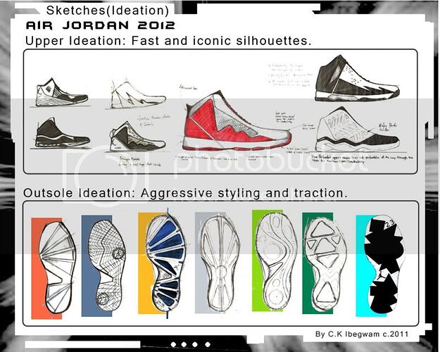

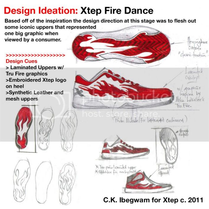

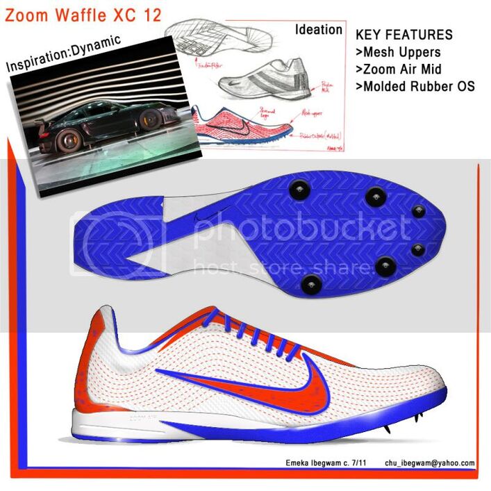

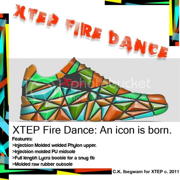

I’ve been designing like crazy mostly focusing on footwear. I probably need 2 go to school but it seems too expensive these days. Any feedback would be greatly appreciated. thank u in advance.
here we go…

I appreciate the passion meka don. I think that if you’re serious about pursuing design you should consider going to school. The ability to network, learn from your peers, intern at potential employers etc. is critical. There are affordable design programs that you can check out. Hit up the Schools and Education forum.

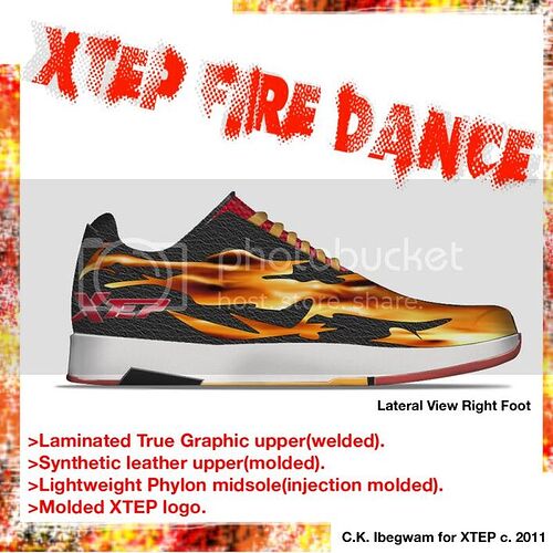

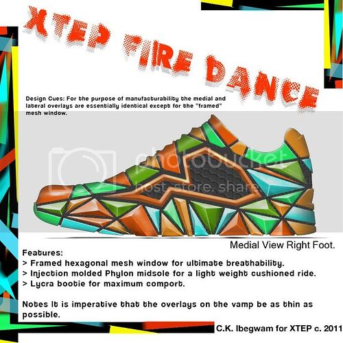

As far as the work goes I think that you’re selling yourself a little short because your layouts are so cluttered and colorful. I think it’s a mistake to include that much graphic layout, it distracts from the true content.

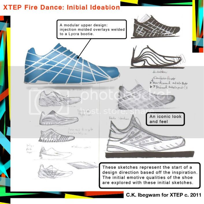

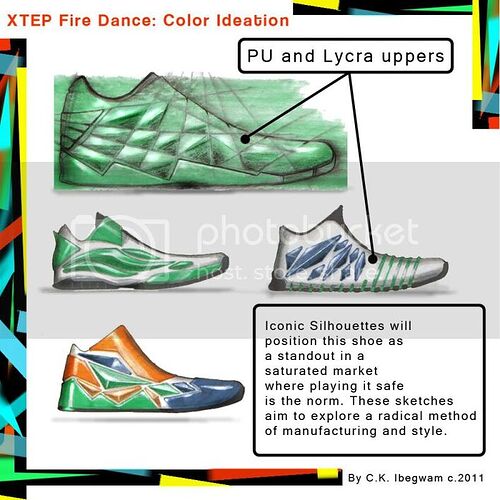

Focus on more sketching and don’t worry too much about renders right now. You have some interesting forms going on in a lot of your concepts but I think they could use another round of refinement.

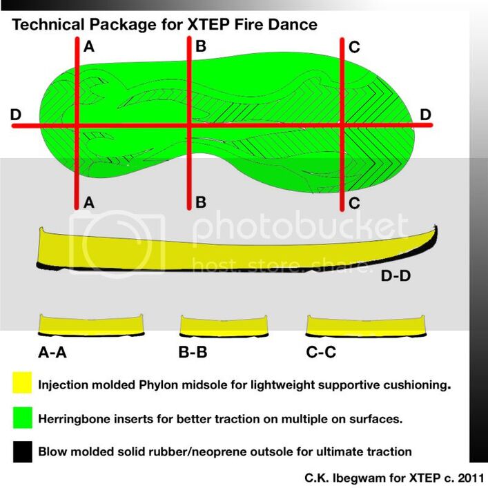

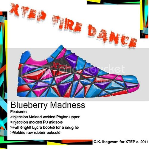

Take off all the extraneous stuff, and just have the shoe on a white page. You need to start with the basics. To be honest, I would like to how well you can mimic an existing shoe render from someone else. Im not a shoe guy, but all of yours are reading very flat due to issues in shading. Learn from others and see how they are rendering. Also, make us focus on the shoe. You can do small call outs (such as material) with plain old text and a leader, but that is about as much ‘extra’ as I want to see at this point. We will be able to critique the work, and not the presentation. I made it through 3 pages of trying to figure out what was going on, then just gave up.

I’m not a graphic expert, but I think a lot of young designers (myself included) sometimes fall into the trap of not leaving enough white space left on the page. Fight the urge to fill up all your space with “stuff”. I think that your designs are already so colorful and impactful, when you add the backgrounds (ie. the Xtep entries) it’s visually too much to look at at once. I think that’s why joyride had that reaction. Don’t take offense, you just have to understand that’s how the work is perceived at first glance, and sometimes the first glance is the only one you’ll get. If I were to redo them I’d drop the backgrounds, give yourself more white space, and drop your font sizes down a bit. Let the work shine through.
I think iterative sketching. Just keep working out the details. I think the designs that you have that have the most sketches backing them up are more refined. The Phoenix fire dance, for instance feels like you just went from a couple of sketches to final render, so the final outcome comes off a little less interesting. This might not be the case, maybe there are more sketches you are not showing but, that’s just my perception. The Jordan project feels a little more refined and thought out. Maybe seeing sketches biases me.

with that said, definitely a lot going on on the page(s)…and the reality of getting someone to take the time to actually look at your work is that, it needs to be laid out in a way that makes the work both easy to understand and follow your progress from concept/problem to solution. Right now there is too much text everywhere, it is too big in some places, and the graphics & text on some the pages compete/take the focus away from your content…

-Sketches!!! these should explain how you arrived at your end design, the what & why of the decisions that you made along the way; using scale and a little text to highlight key ideas in your progress.

I agree with a lot of the folks above, in that right now your presentation is doing a disservice to your work. Too many graphics, bad typography all distracting us from looking at your work, too much noise to focus on the content (signal to noise ratio all out of wack).
