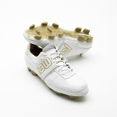

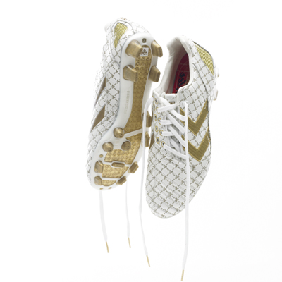

some examples-
more pics
hope this is clear/helps.
