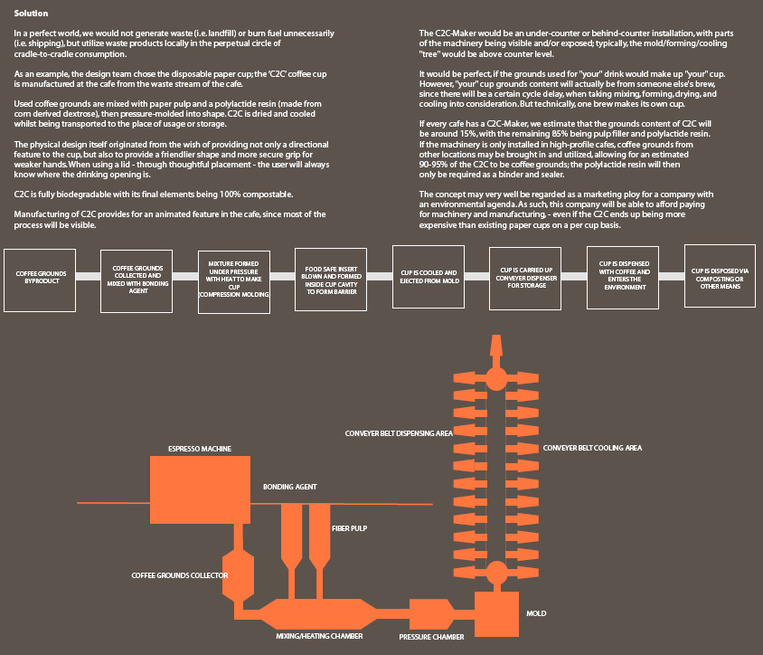

Wouldn’t that be cool?!? A coffee shop that makes your coffee AND your mug!?!
I knew I saw this somewhere… check this concept out - its a cup made from coffee grounds. Concept project apparently
