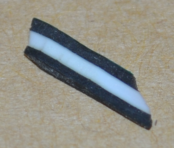

My desktop/cutting board is a Morn Sun cutting mat 9060, made in Taiwan. There is no PVC odor, two years old now. It definitely heals up after a cut from a knife, almost invisible, no raised edges. Die punches leave a more visible mark, but no depth, even if hammered in. This is a photo of a section.
I need a microscope to see closer, but clearly the surface material layers are filled with a particle substance or foamed.
Center core is hard material which is not PE or PP (burn test does not reveal any of the most common thermoplastics I recognize) and harder to a knife point, and is self extinguishing in a flame.
I think there is a temptation to assume that it is just a sheet of stock plastic with printing on it, but it appears there is a complex solution arrived at in this one, and it performs very well.
