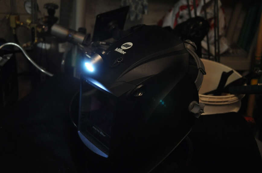

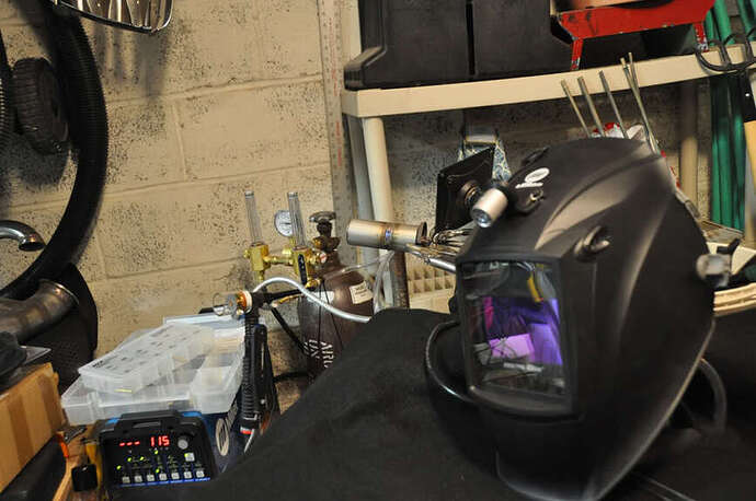

  • Would like LEDs embedded in the helmet for more visibility before welding. This was something I had done with my personal helmet, and I wasn’t sure if it was something that was desired BUT several people on Welding Web mentioned it’s something they have wanter, so something they have retrofitted to their helmets.

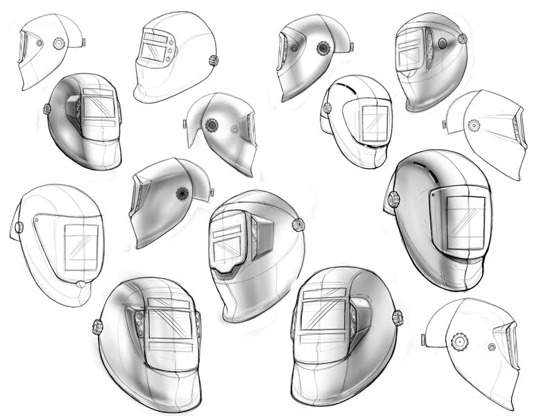

Will have more ideation and exploration work in the next couple of days, here is some of my initial sketch exploration from last week. Going to really get cranking on it this week, I feel like I’ve been dancing around a bit the last week.
I am also in the process of hacking apart some LEDs and hot gluing them on mule welding helmets to test what the ideal placement and number is.

Nice ideation sketches Matt… would love to see some more functional breadboardy mockups hacked together though as a first step.

Sketches are looking great for the helmet feel. I have been working in clay this week on two helmets. I find industrial modeling clay to be perfect for developing a helmet. I highly suggest it if not already part of your design process.
If you need any input in this area I’m happy to help.
Great project, nice sketches and organization-your target crowd is going to be hard to please-little details are whats going to make or break this helmet-but it looks like there are plenty of unmet needs in the industry, and if you can pick one or two major differentiators (lighting/ventilation as an example) this project would be a success. So when customers ask “Whats so great about this helmet” you have a strong reply.
Also- You can get much better feedback if you number your sketches-makes it easier to crit and discuss. You can get a feel for what people are gravitating toward assuming you like the sketches you post.

Some more development work, trying to separate out the concepts and begin mocking up and testing the functional elements
Concept 1: LED lighting
I did a couple quick card board mockups with different lighting configurations. Will be doing some more tests later on today with my real welding helmets and mounting some LEDS on it.

Good stuff, dude! Sketches are awesome, awesome models. When’ll you get a chance to test these with real users?
