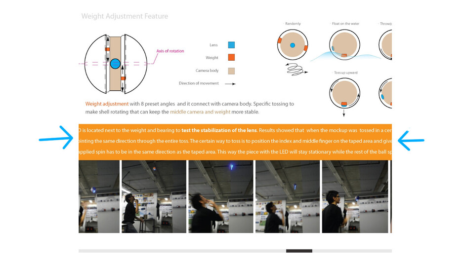

I am currently looking for a ID intern. Here is my website http://dengdesign.portfoliobox.net/
I was wondering if anyone had any feedback. I would greatly appreciate any help.

Hey Deng,
I think you have some really nice work and your process is really thorough. I appreciate all the mockups and scale models, seems like you’re really thinking through the problems at depth.
It looks like you came out with a pretty nice appearance model for the water purifier? Maybe show it off a little more.
I’m not a fan of the site design and horizontal scroll, since some of the content extends beyond the viewable area. I found myself scrolling back and forth to read blocks of text that extended past (see attached image).
If you’re going to do a scroll why not just a simple up/down blog layout? Might make the site more easily viewable on tablet/ipads as well?
Good luck on the internship hunt. Do you have a pdf version as well. I know most of the places I applied to would only take pdf and were not interested in sites.
Thanks! I agree with you, the horizontal scroll seems not friendly. I will try to make a vertical layout soon.
