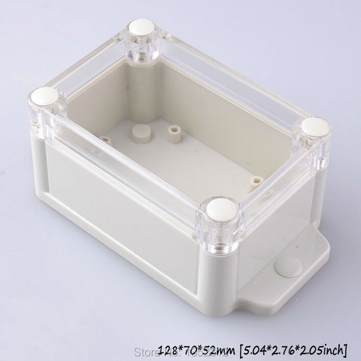

  1. Find a product that is IP68 and tear it apart. Maybe a GoPro is, but you can definitely find an IP68 project box at your local electronics supply store. It will look like this:
Notice that the joint surface is planar and the fasteners are outside of the gasket. Non-planar joining surfaces are a pain to seal properly, especially at IP68.

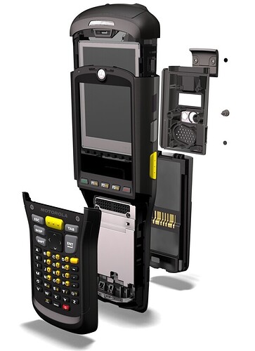

I’ve done a number of products where the seal material itself is over molded on to one of the housings using elastomer and eliminates the need for the O ring (and additional space it drives for the channel and wall thickness on each side).
You can see some of the seal designs on this image - the outer material of the top cap was TPE (though due to quality issues we had to add a third softer durometer material to improve the sealing consistency) and had foam gaskets and poron seals around the openings for things like the speaker and receiver. This was not a flawless design by any means - it took a great deal of energy and rework to get the rubber durometers correct and the multi angled seal on the keypad was a nightmare since it often shifted during assembly.

Second best way is to find something similar and copy it. That’s why I like the project boxes so much. They’ve been around for decades, so they are engineered to just work.
