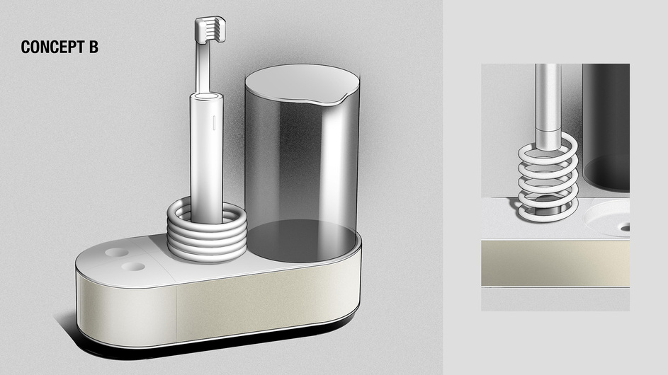

Hey Core77,
I’m designing this water flosser and would appreciate any critiques on the overall aesthetic and ID. Without going into too much detail, the differentiator is the floss tip that has multiple exits for water to flow through, so flossing is faster and reduces error from poor aim. The internal parts are not completely defined yet, hence the different proportions but hopefully these sketches give enough info to start going into a design direction. So far, which design appeals to you? Any additional comments?

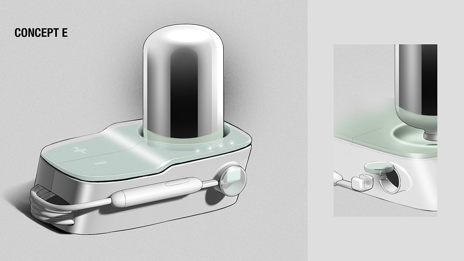

Great sketches! They read well and that secondary image says a lot- that little hatch in Concept E is really fun for some reason.

Personally, I’m drawn to Concept B as it appears to be the most convenient and easy to refill- something I do each time I floss. I’m a little skeptical that water jets from both sides would be an advantage- I like the precision of a tip and the flexibility to point it in any direction. Maybe it’s amazing- it’s just hard to picture.

I like B and C because they don’t seem like they’d tip over during use, and might be easier to keep clean of the toothy muck. The clear top of E is cool and feels clinically-clean, maybe that could be applied to another design as well? I wasn’t that into B until I looked at a larger image and saw the pillowed top surface, which was a nice ‘surprise’. C could benefit from some biggish color breaks.

For me, the drivers for a hygiene product and something in the bathroom is hygiene and footprint. Concept B looks easiest to clean. Something that gets filthy really doesn’t say hygiene to me. (I do like the UV disinfectant “hatch” of concept E, but how do you get rid of the nooks and crannies that will collect filth?).
Concept B also utilized depth over breadth which is always positive for space saving.

B: Better, with more emphasis on the flosser itself. This is simple and inviting. Visually it’s a bit unbalanced and lacks rhythm - it’s a plain buttons - flosser - reservoir sequence and needs a bit more tension. I like the white + sand/champagne combination, you give it an own touch while keeping it universal enough to fit most bathrooms. Also hygiene +1.

E: …great idea on the hatch. I love how the shape feels lightweight. You can extend that by adding a blend to the bottom surface, look at Ora Ito’s work for reference, for example his chaise-longues.
