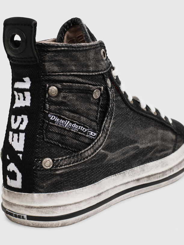

In the past I used a few treatments to have things look a little preworn. The best was a hand rubbed oil finish that just seeped into all the crevices of the textures and made everything look a bit old. Because it was hand applied it was nice and random. Starting with an off white color for the rubber also helps.
This is totally possible and I recall seeing it a lot back around 2007 when distressed shoes were pretty popular. As Michael mentioned, usually it’s a hand finishing process. Similar to how dress shoes are “burnished” with paint wiped on and off. Sometimes the shoe is also scuffed on a buffing wheel or with a grinding disc like a dremel.
Diesel does this a lot.
Oh, and this-
One path would be to purchase some samples like these and send them to the factory and ask them how they would achieve the finish. Check out some of the Varvatos Converse product.
