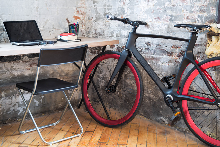

but no brake bosses, no cable runs, no pannier bosses? Surely not clamped onto the frame?

Im not fully understanding why this is carbon? I get that is looks fancy, but for a dedicated commuter that is going to take a lot of rough pavement, I think I would go with aluminum. There are no reasons to go with carbon on a bike of this level. What benefit does it provide? Not weight savings or strength. I guess you could say it dampens the roads, but there have been some really good metal frames lately that would make you question the material. Also, how are they integrating the brakes? Looking at road manufacturers dealing with disc brakes, they have to rethink the frames in order to add the disc. I wonder if they have accounted for this, or just hope the “internal wall structure” will be good enough. I would like to see some FEA data to support any claims on this as well.

Let’s start with the bike setup. A slammed seat and stem spacers to the sky??? lol. It’s like they purposely are in “hipster” mindset - everyone else has a slammed stem and a lot of seatpost showing - let’s do the opposite.
No tire clearance? Looks like 23s are the max size. For commuting??? Even pros on smooth as glass pavement are running 25s.
Time trial rear triangle and flat bars? That combo makes me want to wretch.
Surfacing? Hard to believe but they made their BB more of a turd than Cervelo did back in the day. Let me guess, lateral stiffness, vertical compliance. lol. But the seattube looks the opposite. Transitions from surface to surface are way to exaggerated.
Black on black graphics? How very 2009 of you.
Bright-colored deep Vs? How very 2006 of you.

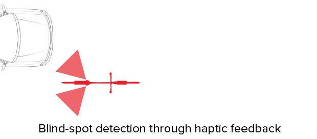

And finally, the first rule of Italian racing, what’s behind you is not your concern. The proximity sensor is just asinine. If a car from behind is going to hit you, its going to hit you. Rear view mirrors and rear view cameras are best if you are riding side by side, see a car approaching and move to single file. Also, I ride with parked cars to my right, will that damn sensor be vibrating all of the time? Can I turn it off? Then why have it in the first place?

If anyone would like to interpret ‘unibody carbon construction’ and why this is indeed better than every monocoque frame out there, including the sizable body of research done by carbon manufacturers like Trek and Giant…and why their sample tubes look like such a damn mess internally…I would love to know.
Agree with the above on the frame surfacing. You want ride quality for commuting, lose the huge frame sections, lose the deep dish el cheapo red rims, and fit larger tires.

I’m just confused about the whole premise of the “blindspot detection”.
When I’m about to make a turn, it’s not the car sitting on my back wheel that I’m worried about, it’s the car that’s another 15-20 meters back (you know, the one that’s ACTUALLY in my blindspot) but approaching fast that’s going to cause issues. So really, this thing only seems to pick up the cars that I’m going to spot relatively easily on my own.
The argument doesn’t really improve much if you assume this device is just for detecting cars that are about to pass you while you’re riding straight, because by the time this thing picks up a car that’s overtaking you, it’s basically too late to do anything about it.

I kind of get the blind spot detection - sometimes I’ll miss a car when I start to turn, so it could be useful. Granted, I have yet to be run over so maybe it’s not that much of a benefit.

The bike’s CF stylings are a bit… over the top? Why do the chain and seat stays need to wiggle like that - what’s wrong with a straight line?
