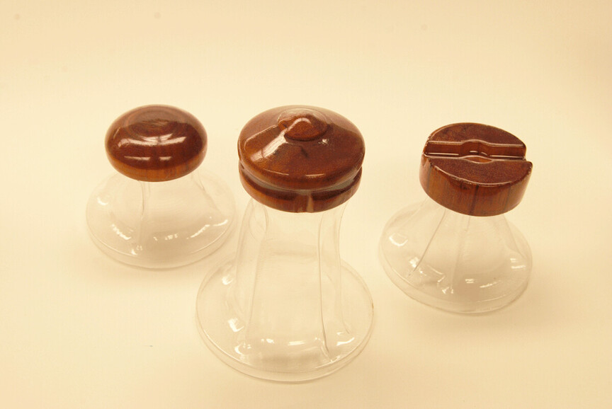

So the final project of the first quarter of ID is a family of form project, and we had to design a chess set where all the pieces read as, well, part of a family. I did a vacuformed one inspired by the RIK stool:
after a ton of experiementing (like 7 or so rounds) I finally got it to work properly, and thought I’d share the project with core:
[vimeo]http://www.vimeo.com/17721530[/vimeo]
(careful, it’s a rather loud video because the air compressor was running while we filmed it)
It worked almost perfectly, except for the king, where some extra webbing occured that makes it look kind of lopsided.
The process I went through was that I modeled the pieces up in alias, and CNC’d out the bases of three pieces in REN. The bases included controlled webbing to try and prevent the plastic from bunching up where I didn’t want it to, and the top pieces were lathed out of padauk wood. After using a couple of tricks, I was able to form it directly to the mold+wood combination, and pulled the REN bases out from the bottom. I think it came out pretty neat, so I just wanted to share it here!

choto: we didn’t have to think too much about the chess board- the project was mostly designing the relationship of form between the pieces and making sure they look like a family. As a result, I took a few liberties in terms of piece size and made them a bit larger than standard chess pieces, mainly for two reasons:
  1. The end result of the process is very “touchable”- at a small “standard” size, the pieces simply wouldn’t be as interesting to hold as larger pieces.
  2. To get the proportions of the pieces to vacuform properly, they had to be sort of fat- If they were small (skinny), then they would be really, really, short.
The end result is that, if these pieces were to be played with, the board would also have to be a bit larger (though not much- the bases would probably only extend a little off the squares on regulation boards).
In terms of differentiating between the two players, I was thinking it would be cool to have a stained wood vs. unstained: padauk is a ridiculously orange wood, so unstained (I only used some tung oil to bring out the darker color), it would be really noticeable as to which side is which.

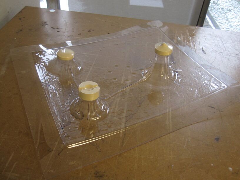

Pdog- the mdf box helps force the PET plastic into the mold’s shape:
I had the problem in earlier experiments of webbing stretching across the entire PET sheet. The box not only prevents this from happening, but it forces the PET to at least travel the height of the form, breaking the usual 2:1 vacuform ratio. To get the size of the box, the width of the box is the height of the piece+width of the piece’s base, and the height of the box is a little less than half that number, keeping it within the 2:1 vacuform ratio. It sounds way confusing, but the difference between using the box and not using it is incredible:
the webbing occurred in the styrene because the ratio of the box’s height to width was off.
I know it’s kind of confusing, but I hope the explanation made sense!

Just curious enio, did you try using any kind of “plug assist” to help get the material down into the cavity and reduce webbing? There are different ways to use them, simultaneous with the forming cycle, and making a sheet of “pre-formed” material which is reheated to make the final part.
http://plastics.turkavkaz.ru/processes/thermoforming/plug-assist-forming/

yssagul- We developed a bunch of different possible designs in terms of how to differentiate hierarchy in a family of form (one of the main goals of this project). Movement was one of the ideas I was throwing around, however I ended up going with size/shape instead. Next to the queen, the king is definitely larger and more “threatening”- but by itself it is left ambiguous (one of the problems with an incomplete set…). I tried to put some type of cross or plus shape, but that would have messed with the height ratios I was playing with.

Lmo- This was an unassisted vacuform- The machine we have on campus isn’t really conducive to having a secondary piece come from the top. Initially, I played with the idea of poking it with a stick or blowing compressed air to push the plastic over some of the harder to cover spots. Luckily I was able to avoid doing this with the bounding box I mentioned earlier- while some webbing did occur that would probably have been prevented with an assisted vacuform, it doesn’t overwhelm individual pieces like it did in earlier trials.
