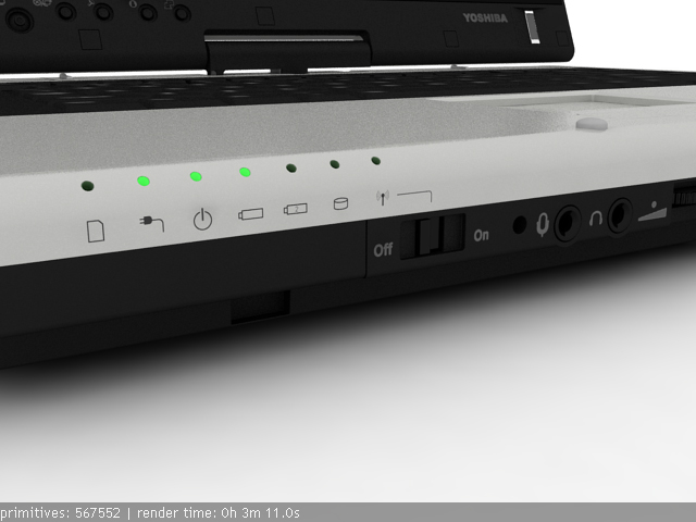

I know people that use vray and I’ve done a couple of renders on my own and after a few tutorials, you can get really good looking images quickly. Using a simple setup (basic lighting) , at a small 800x600 I would get a decent rendering in under 8 minutes. The times increase when you get really close to see the material textures but for a medium range shot it’s pretty quick.
Granted I’m pretty new to rendering but these are some samples from my 2nd and 3rd try with vray. The mouse is just with default lighting so it’s nothing special but for quick visualization I think it gets the job done for the time it takes.
How does v-ray handle decals? And how does the interface plug up with Rhino? Nice defused shadows btw.
There is a plugin for rhino. I’ve used the max version but learned reading a tutorial for the rhino version. I cheated with the decals by just making the decal the same size as a plane and then using the flat decal as a material and its outline as an opacity mask (to make the rest of the plane invisible so that you just have the graphics left) and then just lining them up with the surface. I haven’t tried doing it for a curved surface, no time to experiment but I’ve been told that it’s just like how you would do it in max normally, something about making a custom uvw map I believe.
