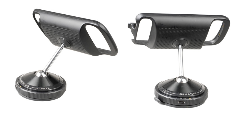

Comments on design: why are the “jaws” so deep? Couldn’t they be half the size? It looks kinda big and clunky… And actually I’m not sure about the holding mechanism, will I be able to quickly remove the phone with one hand to take a call? That’s essential.
Can it be mounted on the dash? Suction cups work bad with curved textured plastic surfaces… I would also get rid of at least one logotype.

Surprisingly the holes is actually really quite small, the render just make ti look big. Also when it’s not in use and the holder is closed it’s even smaller and looks great just on it’s own. It was designed in mind to compliant todays phones and also cars.
the ‘jaws’ as you say are that size due to making it as universal as possible and to also give the hold that it needs as the last thing you want is for the phone to not be held securely or to be shaking around.
The holding mechanism is actually very very easy to use and very quick to release, that is what I love about it so much. It is of course much easier to release with two hands but can be done with one hand.
It was actually a very big challenge to create a holder that is very stylish, works fantastic and is a universal as possible, that is why we believe this to be the best example out there. It was also a very big challenge fitting all the mechanisms in such a small device.

If design is supposed to be a big feature of this, to me it doesn’t cut it. Why are the clamps so deep? The phone is thin, this looks like it was made to clamp a brick. Why the placement and detailing of the buttons on the side of the clamp? Looks kinda random. Why the size/shape of the clamp? Doesn’t relate at all to the shape/size of the phone.
I don’t know bout function as I’ve never used a clamp or existing gps but this is not something I think that looks “designed” or premium or compliments the phones aesthetic. I don’t really see anything that novel in function either.

Well if you can’t see it then I guess you can’t see it.
I would suggest to search online for images of other holders out there for a little comparison and that may help.
This is actually a universal smartphone holder, not an iPhone specific holder, so the clamp was design in mind to cover as many different types and shapes of smartphones. Some cases do make a phone thicker and to me it’s must that the clamp must be able to hold the phone securely so the extra little depth also helps with this.

Universal works from manufacturing outward, one SKU, one set of tools, one sales pitch.
However, the user has one phone. One thickness, and wants the optimum. He or she does not care about the process. He or she wants it to fit their phone like a glove and not look awkward in the middle of the windshield.

I believe this holder actually looks amazing when not in use, so when it’s fully closed, that actually gives it it’s small form factor so I wanted it to look good on it’s own when not in use and I believe it does this amazingly well.
We have tried to get it as small as possible to give it as slime a profile as possible but it is a huge challenge when implementing the type of clamping mech we have used so I think overall the experience is a great one.
