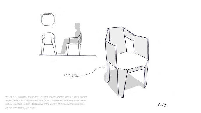

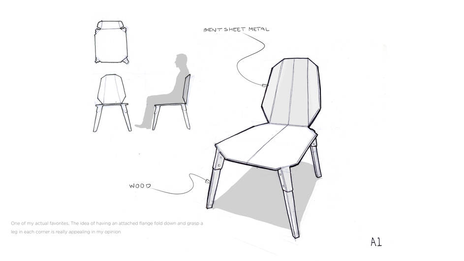

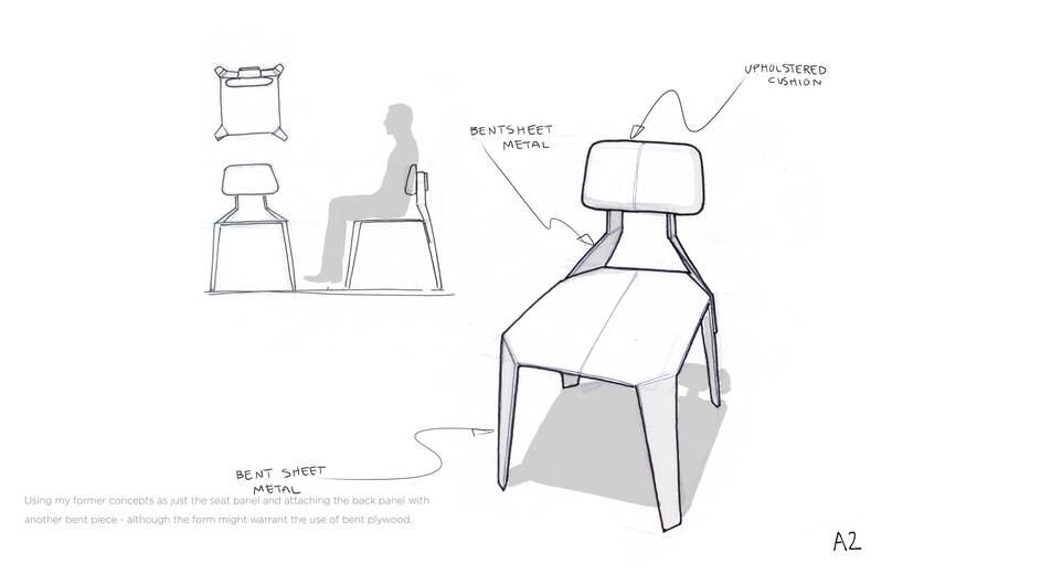

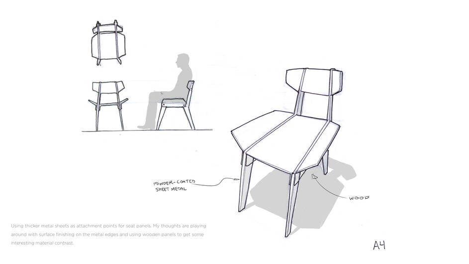

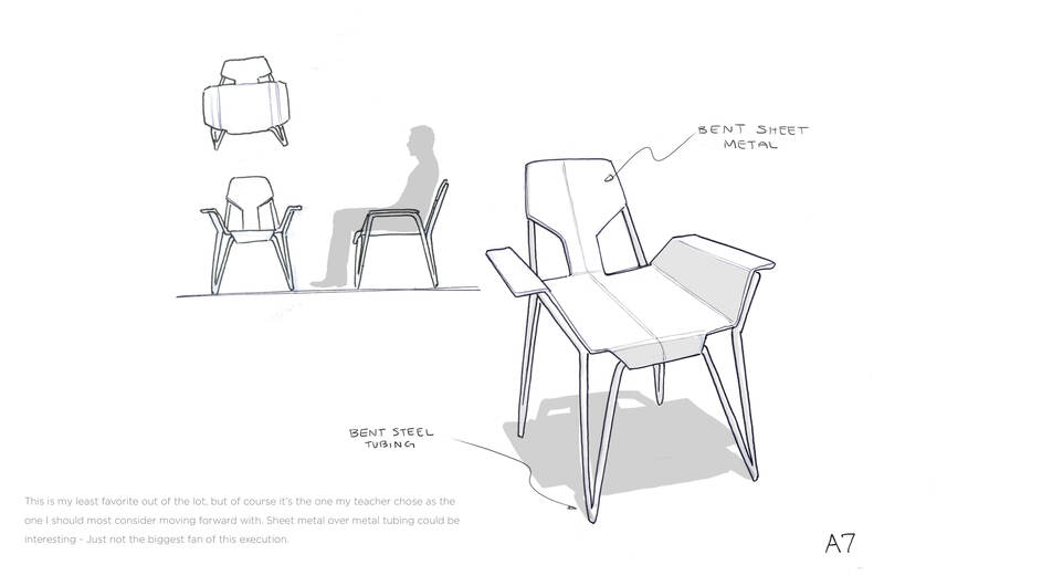

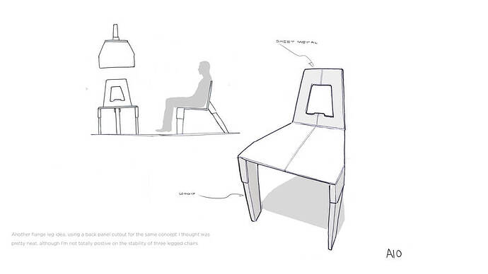

Here are the 20 designs I didn’t present today - anything interesting you see that you’d recommend incorporating into my next steps please let me know!

Im partial to A2 and A18, but don’t really feel like any of your chairs really have a Wow factor yet. The story/movie aspect is ment to push you away from designing “just a cool chair.” Having a narrative to your design will help you craft a more meaningful product in the end. Even if the story is “low cost manfucaturing”, “dorm flat pack”, “muji-esque”, “miyazaki” “space odessy” You need something for the viewer to latch onto. Right now you just posted some chairs, with no back story to them at all. Your images and sketches need to “present” your concepts. Your sketches as is don’t really do that yet.
You have some beautiful imagery on your boards. But nothing that really feels like it ties to it. The blobly shape pushing through the rigid frame is interesting. The quilt pattern is beautiful. The facteted planes. Try and incorporate that more into your designs.
Other avenues you might want to consider. What environment do you see these chairs living in. Surely theres a perfect living room you see these sitting in. Show us that room.
How did you settle on bender metal? Did you explore anything else? I think that some variety in material explorations in the beginning could spark something interesting. Maybe lead to a unique material combo or form factor.
Did your brief have any other details? Price? Consumer? Use scenario? I’m feeling some basic foundation is missing and makes it harder to evaluate if you hit what the target is.
