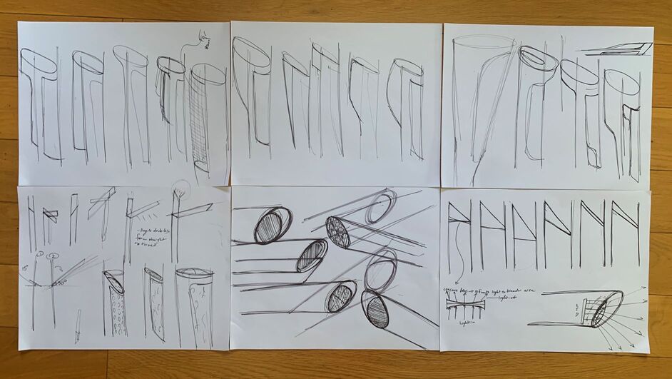

Nice work Ilan! This is a great project for someone still in high school. I see that you are making little part gaps. Details like that really help. The design itself is clever. Adding some arrows showing the pivot could help drive the functionality home. Also, I’d love to see a sketch ideation page at the beginning to see what shapes and details you explored.
As the others have mentioned, great work - Especially for being in high school! I agree with Michael as far as understanding more of the ideation as I think the main body/tube, switch, and base could be more cohesive in terms of form. Also think about the experience and interaction the switch plays, I think the rotary switch is nice in a way because it plays off the rotational aspect of the design, however it would be interesting to explore capacitive/touch switches as well. I have worked on a few lamps, if you have any specific questions feel free to DM me!

Here is some of my ideation. I added more on my Behance.
