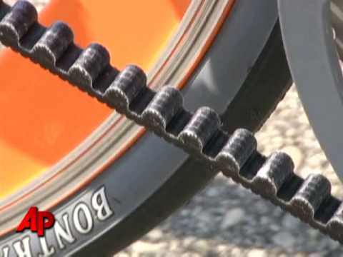

and every review I’ve read speaks of the “maintenance-free, lubrication-free, stretch-free” carbon belt drive.
How can anything be lubrication-free? Won’t that increase wear between the carbon chainwheel teeth and the carbon belt? In my experience normal chains wear out mainly from teeth wear, made worse through lack of lubrication and cleaning.

Yes. I have. I’m not sold on it, and I work part-time for a Trek dealer. I should be falling all over myself for it. Nope. Here’s the deal, they don’t always stay on, and you are very limited in your chainring/cog choices. It’s not impossible to imagine, the tech. basically came out of snowmobiles, but in this application it just isn’t quite there yet. It doesn’t wear nearly as much as metal on metal and “carbon” is sort of a relative term. The chainrings and cogs are steel. It’s maintenance free because you don’t need to lube it, but you will need to tighten it just like a singlespeed chain. It will wear out over time.
It also makes an awful noise, and feels very foreign. There’s noticeable slack in the drive, too.
It’s not so bad mated to an internally geared hub, but it’s just not quite there yet.

I think the only reason you lube a chain is for the link-to-link wear. This doesn’t have any links, it’s like the belts in your engine.
And for the link to Chainring/Cog wear. Typically, as chains wear, so do cassettes (the gears on the rear wheel) with out lubrication, they wear much more rapidly, shifting suffers, etc. When it’s time to replace a chain, it’s usually time to replace your cassette because they wear at almost the same rate.
Hmmm, so it does have metal on metal wear, will wear out and stretch…I wonder if it makes that fan-belt slipping sound when it gets worn?

I found out some stuff about the belt drive. They are made by the Gates corporation, who make belt drives for motorcycles:
http://www.gates.com/index.cfm?location_id=557
and of course because you can’t cut a belt drive like a chain, the frame needs to be split (or they could go down the elevated chainstay path). I wonder how whippy the rear end is:
http://safehydraulics.com/ptdesign/trek.html
The pros are it’s really light (80 grams- an XT chain is 304 grams) but an internal hub like a Rohloff speedhub is 1700 to 1825 grams without the belt adapter. An XT rear end is about 911 grams (sprocket 275 gr, rear hub 411gr, rear mech 227gr-approx.). If the durablity/ reliability is good, if would be a great touring setup.
http://www.rohloff.de/en/info/faq/faq_detail/article/Gates_Carbon_Drive_with_Rohloff_SPEEDHUB_50014-1//bp/284/index.html
This bit is interesting. What is the typical life of a bike?
Sprocket wear posed another challenge. Initially, Trek tried anodized aluminum sprockets. The sprockets were tested on a prototype bike that was ridden in several single cross racing events. Trek found that the contact points between the belt and the sprocket had worn. That led to a consultation with Gates engineers, who recommended a proprietary flame spray coating called Armour-GK™. This coating improves sprocket wear resistance and durability to the point where the sprockets are unlikely to wear out in the life of a typical bike.
Treks warranty is lifetime for frame, Bontranger components 3 years, and Shimano components are Shimanos warranty (2 to 3 years). Gates say “twice the life” of a chain.
