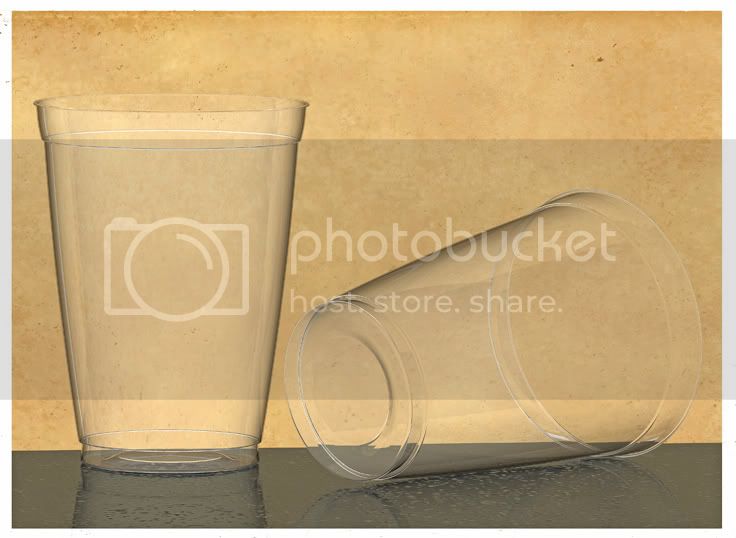

Here is a quick plastic cup sketch done in sketchbook, and a rendering of the refined design done in NX (It’s what I have to use :unamused: )
These are the type I show in meetings.
NX is great for modelling (if not the best)…Not so good in the rendering department :wink:
And I would change the background…Now it looks like some ancient Roman Cup you dug out :wink:
