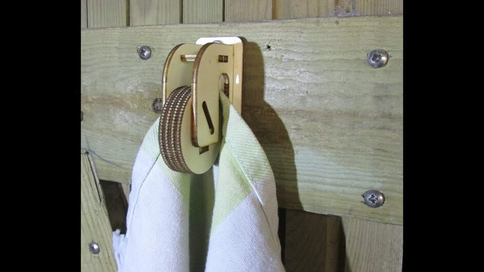

My first post here so be kind! (actually, just be honest - I much prefer that). The other day I got annoyed that some of our towels were missing the strap to hang them from and consequently having them come off the hook. I quickly drew this in CAD and cut in on my laser. It works well. There might be one like it out there but I have not come across one for towels. I have a modified version drawn that is folded up from a piece of laser cut stainless steel. The wheel would be knurled and turned from stainless or brass. I’m considering having a few hundred made to see if they would sell. I know a friendly CNC turner and metal laser cutter so the outlay would not be huge.
Pretty clever little idea there! I haven’t scene anything like it either. I definitely think other materials would be something to look at. Obviously once in metal you can look at a number of finishes and likely could make it a lot smaller as well. From a pure aesthetic POV I think could you could iterate on it to make it feel a little more holistic, a little less DIY, but the core idea is very nice. A few hours sketching on a dozen aesthetic remixes and I think you would have something really nice. I could see you going for this kind of look: https://busterandpunch.com
That is a nice look, thanks for the link. Made from metal it would indeed be smaller and look less “homemade”. I can’t sketch freehand and am still trying to come to terms with 3D CAD. However I have a comprehensive selection of tools and machines so could relatively quickly make some prototypes. For development purposes it would suffice to have the sheet part CNC plasma cut which I can get done locally. I have a lathe to make the wheels on. I was actually visiting the guy I know who does CNC turning today. He suggested a diamond knurl on a brass wheel and a glass bead blasted finish on the steel might look nice. Alternatively it could be power coated (I have equipment for that). A brass wheel might look good against bright colours or stainless against pastels.

Keno, the weight of a brass or steel wheel should make it one handed. I have the hole in the wheel slightly off center which will also help with the locking action. Metal wheel could be smaller and would still be a lot heavier. I like the look of the full wheel so will stay with that. Easier from a manufacturing perspective as well as it is just a bore, turn and knurl job. Fast on a CNC lathe and easy enough to do on a manual lathe.

Here is a sketch of the hanger frame. I would have it cut from 2mm stainless steel. This would be used with a D25x20mm wheel. It would have a section of T2 timing belt or similar bonded to it to create friction against the towel.

I agree with Keno that this item can be much miniaturized.
Though, implementing the wheel gives it a unique aesthetic which fits the popular industrial interior styles of today, especially if you make the wheel out of copper or brass.
You can replace the timing belt with a torsion spring principle which leaves the beautifully machined wheel more visible.
I have brass in stock so the prototypes will use that for the wheel. There are many options for the frame in terms of finish. I would be brushed or glass blasted stainless steel or it could be powder coated or chemically blackened steel.
