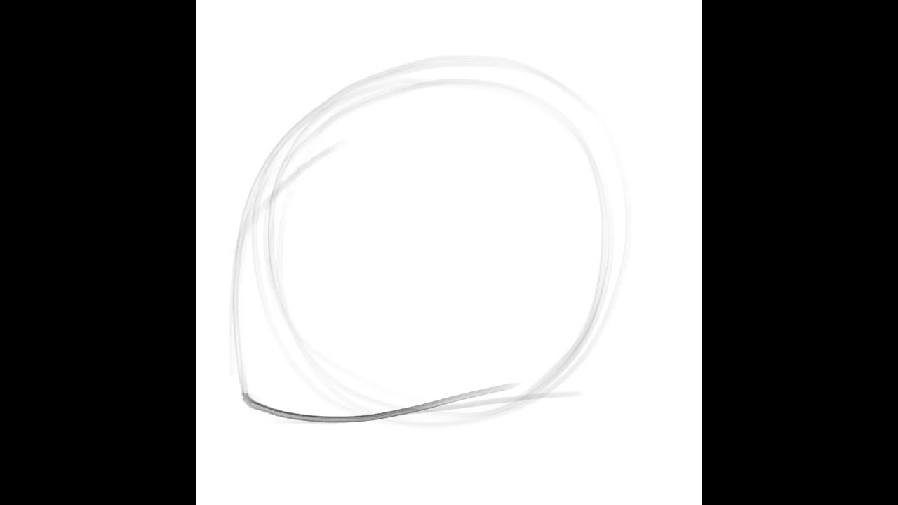

Helmets are fun to sketch on but deceptively tricky. We did a line of helmets for Biltwell last year. Getting the proportions right is essentially. From a macro standpoint though I think the two biggest things that would take your sketches to the next level are line quality and line weight.
Line quality: When I say line quality, what I’m looking for are long, continuous marks. It looks like you might use a lot of short markers that give the sketch a bit of a stop start quality. A lot of “ID” style sketches use longer markers that are more continuous. You can practice these by drawing lines on a page using different parts of your arm as a pivot. For example pivoting from your writs, your elbow, or your should will give you three very different lines. Control the length, the position on the paper, and the angle of the paper and you can draw just about anything.
Line weight: You are already using a very light line weight for your construction lines and a medium line weight for your design lines. That is good! Take that a step farther by introducing some heavier lines. A good rule of thumb on those heavy lines is anything that you could get your fingers under if the product was real should have a heavier line. So the outline of the product, especially the lower side, can get heavier lines, but also maybe the inner edge of a vent or the lower edge of the visor.

Thank you Yo for the breakdown of line weight and suggestion for using different parts of the arm. Line quality tends to be a sticking point for me so I’m excited to approach this weakness from a new angle. I was under the impression that using the wrist was somewhat looked down on in industrial design sketching? That said I still see designers use their wrist on tight corners.
Thanks Keno Leon, glad to see another self taught person out there! I had never heard of pureRef but I’m getting it now. I’m gonna try and apply your approach and speed the next time I make thumbnails. Often I feel like I’m taking too much time on them.
this is digital but it gives you a sense of what I mean by those flowing lines:
