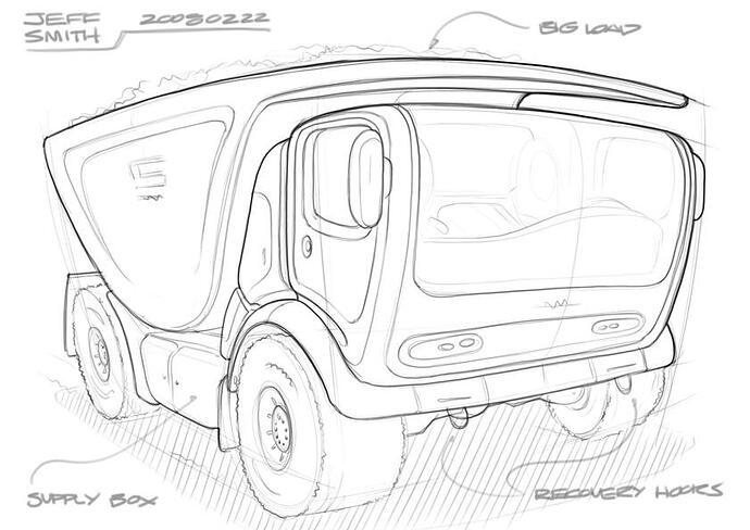

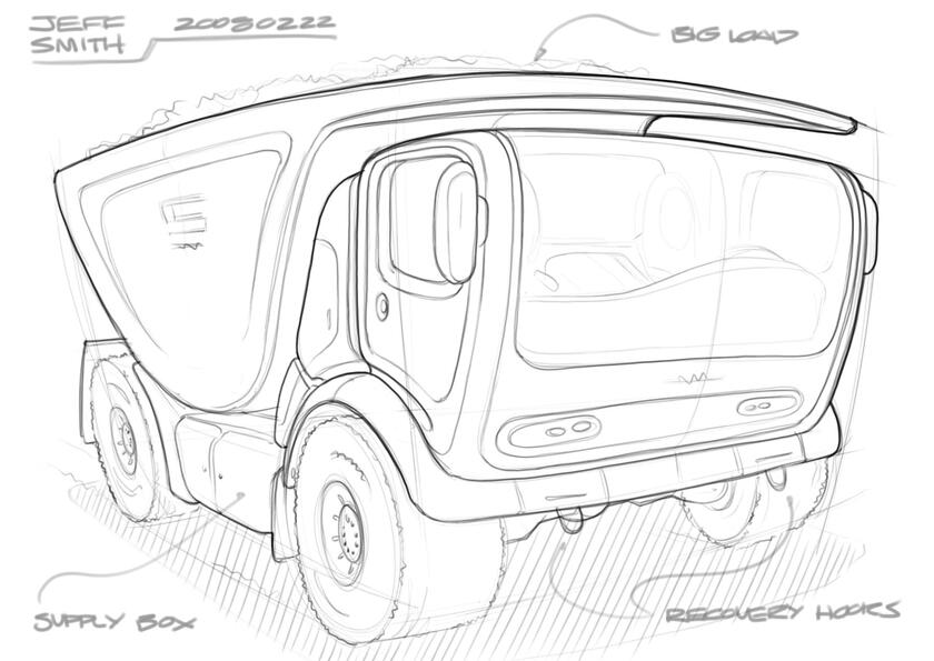

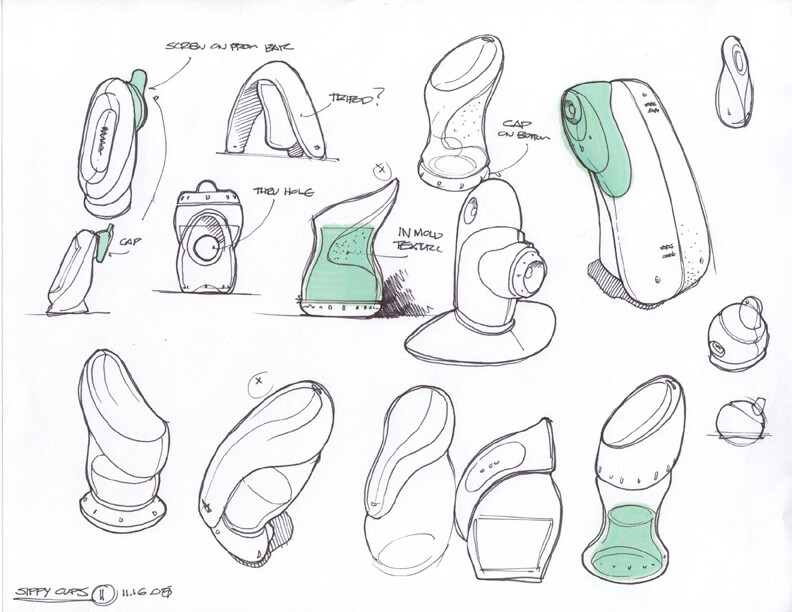

Clean line balance. You should have three basic line weights.
1- Bold, for the outside lines of the item.
2- Medium, for openings in the product
3- Light, for details, edges, corners and such.
The balance of these three adds power.
Here are a few examples from my coroflot page.
Also, your ellipse practice is wrong. Get them on the correct axis.
As Yo mentioned, stick to pen on paper. Digital can be learned later. Line control is the foundation.
Sketch on a few sheets of paper stacked up. Also learn more photoshop basics. Other then that keep on rocking.
