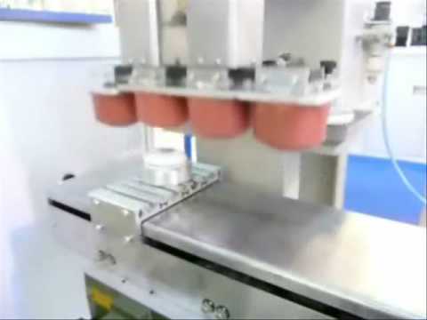

I found a few videos if you’re interested:
