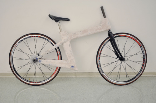

Just giving you all a sneak peek.
Here is a rough form of our main structure.
We welded a steel structure. Then CNC’ed pink foam and fiber glassed. Now we are on the bondo stage. Everything is going smoothly except for this part.
Which is going to need a few hour of TLC :neutral_face:

I hate to bring this up so late in the game, but you may have a significant issue with pedal clearance, unless you plan on using really short cranks. It appears that your bottom bracket is very low, at least where you have it mocked up anyway…
Ignore the wheelbase, I scaled it based on the wheel size, so it may be a bit off. However, I still think you’re a little low on the bottom bracket just by looking at it. I hope it’s just a function of the shape of those tubes.
Looks like you’ve got plenty of work ahead of you.
We are probably short about 4cm. Which for all purposes of the physical model is ok. The way we constructed the model was probably not the most accurate having to make the skeleton separate from the frame mill. Ideally it would all be perfect, but it is our first time building a frame from scratch and its based on a non-existent frame (though we’ve referenced specific geometry).
But that is something major to double check for our 3d model. We scared ourselves last night thinking the cranks would hit the chainstays during the pedal stroke and has to mount in the bottom bracket and cranks just to check (thankfully we are ok).
I can give a little more background on the process since I am one of the guys whose been building this frame prototype (there’s two of us mainly). We decided early in the quarter that we wanted as close to a functioning electric bike as possible. So to make a ridable bike we felt it was best to weld an underlying skeleton for structural support and mill foam for the form. Once we welded up the skeleton, which was a mash up of pieces of old bikes, ordered parts, and new tubing, we had to cut out the inside of our molds in order to fit the skeleton. That’s the stage where things became pretty challenging. Lining up all these things digitally isn’t a problem, but when it came to the prototype it was much more challenging. Then came the fiber glassing. That process is something we were familiar with but have never done on this scale. All in all lining up the foam, fiber glass, and skeleton gave us a fairly rough, yet extremely sturdy frame to shape into the final form.
All this really leads to a frame that’s close in both form and function. It will be ridable, and if we had a battery we could make it run with a motor. The rest of the components were kindly donated by SRAM. And with the amount of work still remaining and the little amount of time we are rushing and hoping that the rest goes fairly smoothly from here on out.
Thanks again for all the input. We’ve been getting help from whoever is willing to provide it.
-James
Just toss on some 165mm cranks and you’ll be fine! That’s cool that SRAM donated stuff to your project. Nice to see a good company like that reaching out to students. Thanks for the insight on the project. You guys have taken on quite a bit of work for having never done this before. I hope it works out well for you guys.
