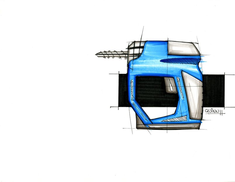

Used a sharpie ultra fine point for these sketches. My line work isn’t as good as with a ball point (hopefully I can improve this), but I like the sharpie because it really makes me commit to lines. Also, I’m not sure if my cast shadows are correct?

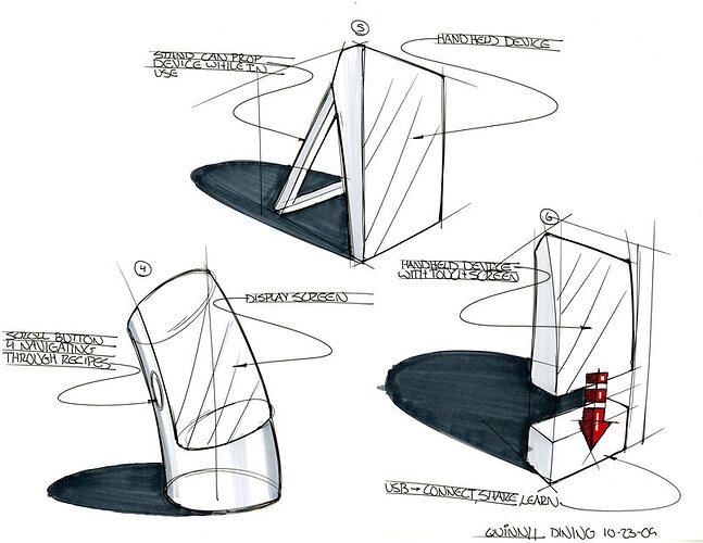

Here are some “just for fun” sketches and some from projects I am working on in school right now.
Great improvement!!! Keep it up!

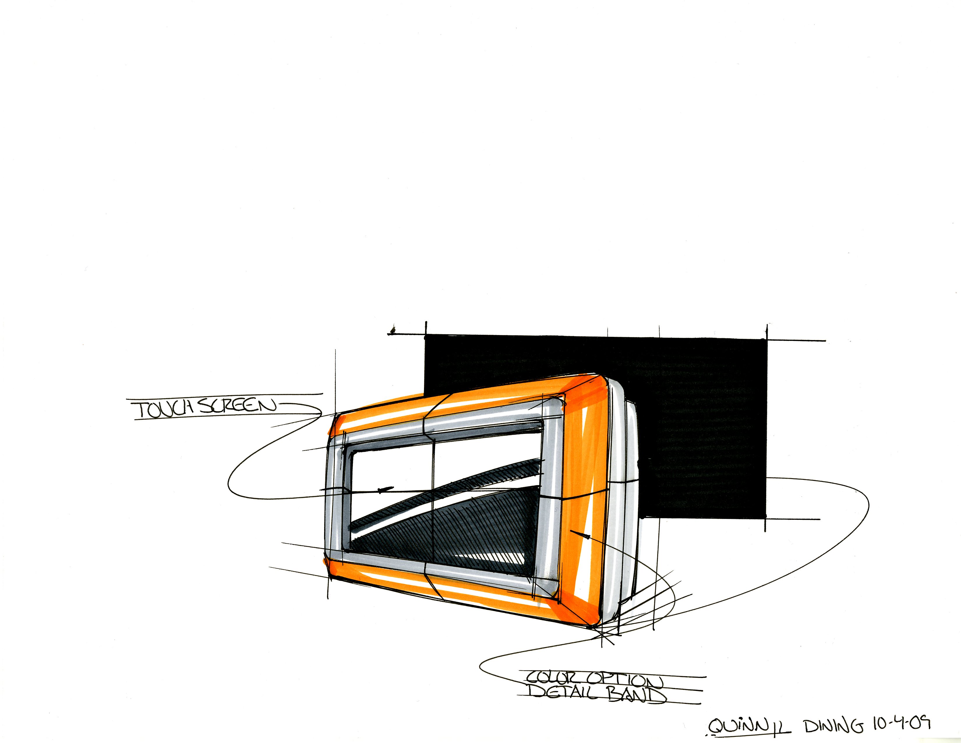

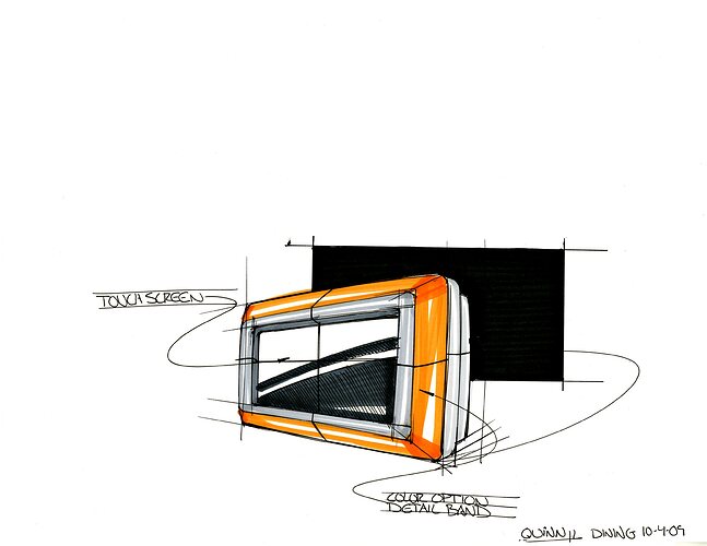

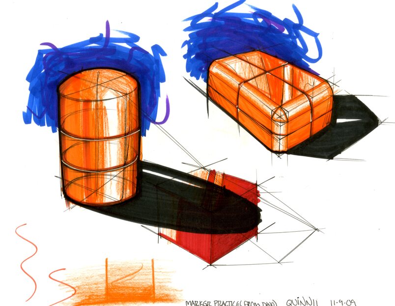

Practicing marker renders from the “sketching: drawing techniques for product designers.” Tried to use my dried out true blue marker on the third one, but didn’t turn out the way I thought it would haha.
I second my previous quote…Great improvement. My only comment is that I really do not know what it is that you sketched in you last post. Try to work on you communication skills in you sketches. Remember you are trying to communicate an idea visually and if that includes showing the product in perspective or detail views to get that across then that is what you need to do.
Good job and keep it coming!!!

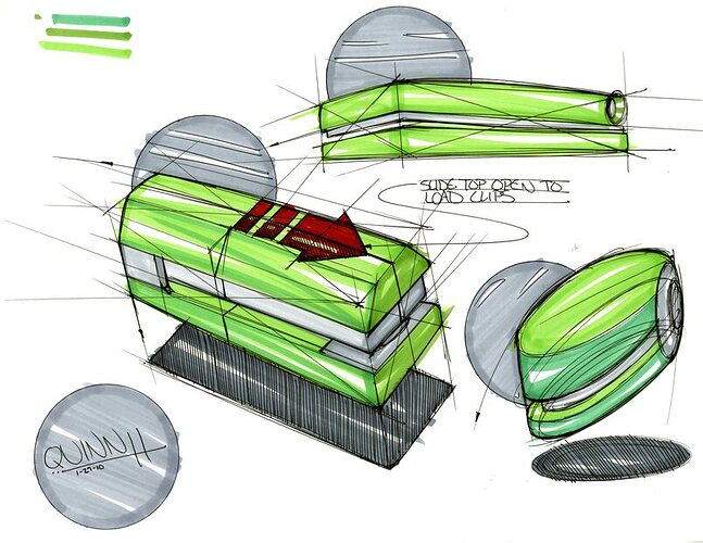

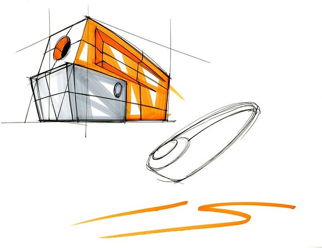

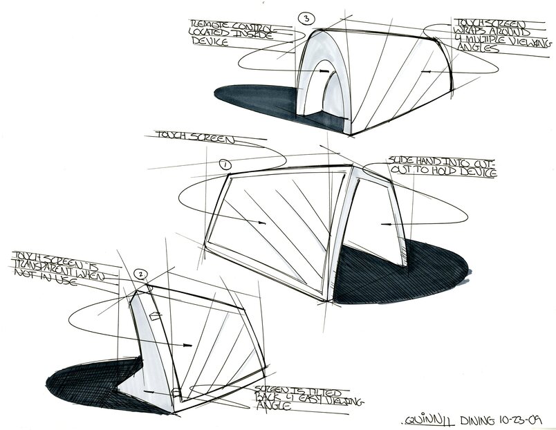

Thanks for the advice Package_ID. I have been practicing different viewpoints to convey a idea or just give the sketch some energy. Here are some fun sketches and process sketches for a project I am working on right now.
One more…

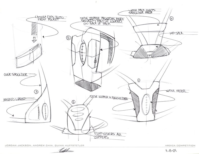

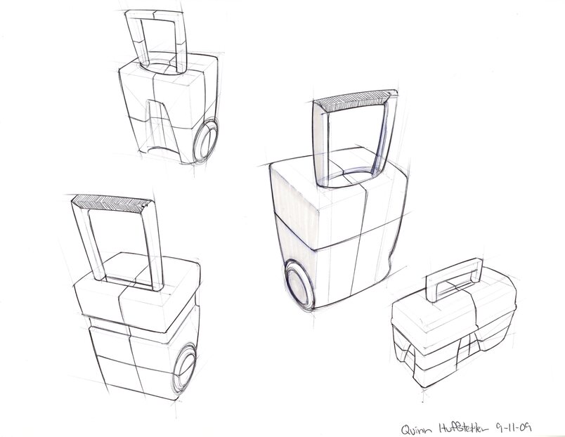

Here are some more sketches that I did for fun. I am starting to learn some new techniques from a friend in my studio using pencils and markers to render a sketch. I am hoping to keep posting on this thread to try and document my progression, so I am open to any comments or suggestions for improvement along the way!
inspiring progress man, damn.
loving the exploded view of the luggage carrier. uve improved thru each posts,

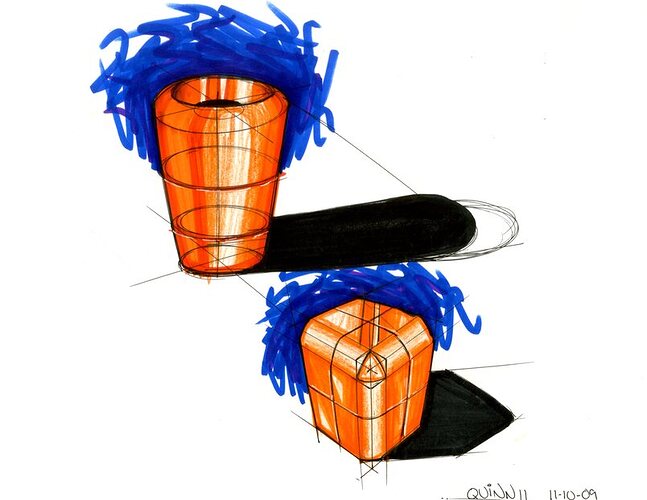

I notice that the best pieces here are the ones copying/mimic other people’s sketches. Nothing wrong with that, it’s a great way to learn, but try putting more of what works in those sketches into your own sketches. It will help you understand the techniques better. Still some nice progress here, but pay some more attention to shadows:
1)On the pictures on top of this page and bottom of page 2 you have some quite angular looking objects, but a curved shadow. Looks odd.
2)On the cylinders on these two last posts (the orange and blue) you’ve placed the highlight on the cylinder in the shade).
Also, I think the fuzzy, blue background is not acting as a background on these last ones. It is taking far to much attention.
