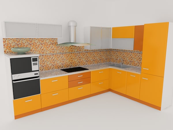

Help! I have a project due next week. We are participating in the Electrolux design competition as part of our project. Whether we want to submit our work or not, is up to us. Anyway, I decided to redesign the washing/drying machine experience by creating an unconventional laundry appliance that fits under kitchen counters (made for small apartments). Well, I wanted to make my concept somewhat believable and offer my appliance an environment so that the viewer can visualize it better in a setting, versus just a nice product render. I was able to find 3d model services that sell readymade models of kitchen interiors and I wanted to buy one and modify it slightly so that my appliance concept fits in it.
Well, a few of the companies I found online, like Turbosquid.com, offer readymades but they are not made in Rhino (which is the program I am using to build my product concept). I m also fairly new to 3D modeling (been using Rhino a few months), so I have no understanding of file importation, polygonal versus NURBS file formats (as it seems all of these models are made in 3DS max, OBJ and 3D studio, which from my understanding are polygonal based??) and whether these models will be useful to me. Turbosquid does offer free file translation, but doesn’t say if Rhino is offered.
Here are a few links to the ones I am considering. Any knowledge of these sites or suggestions ,would be greatly appreciated. Thank you.
