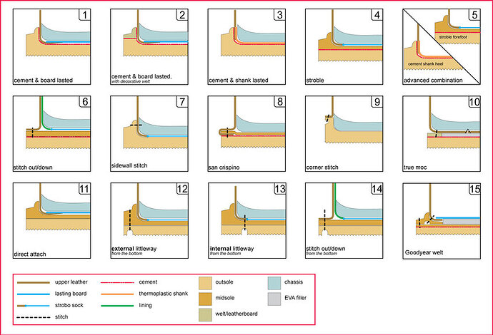

Maybe this will help:
Yo,
I’m wondering where that image came from?
Erick
I have a quick question regarding the Goodyear Welt Stitch construction (shown above in YO’s post):
Where does that sole stitch go (connecting the welt to the outsole)? In other words, how does the stitch go in and out, since it doesn’t go all the way through to the bottom of the outsole?

The outsole stitch goes all the way through the sole or midsole. Usually it is buried in a groove so it does not get worn through immediately.

Thanks Riotgeer. I understand the channel/groove method and have seen that used on some shoes and boots. But what about shoes/boots that don’t have the channel or groove? Is that possible? I have attached the diagram from YO’s post— how does that stitch go in and out, since there is no groove? Thanks…
i think in those cases (and the picture), what it is is two different layers of outsole material. You can see in the picture the top of the outsole that the stitch goes through is darker in color than the bottom. It also shows that red line of cement.
This would be something like where the top “outsole” part might be leather, and the bottom rubber, for example…
Richard has that right.
In this type of footwear, if there is a cemented outsole after the first one is stitched on- the first one is referred to as a midsole.
The image Yo posted is wrong BTW- pay close attention to the image I linked to where the upper meets the insole and is sewn to the welt.
