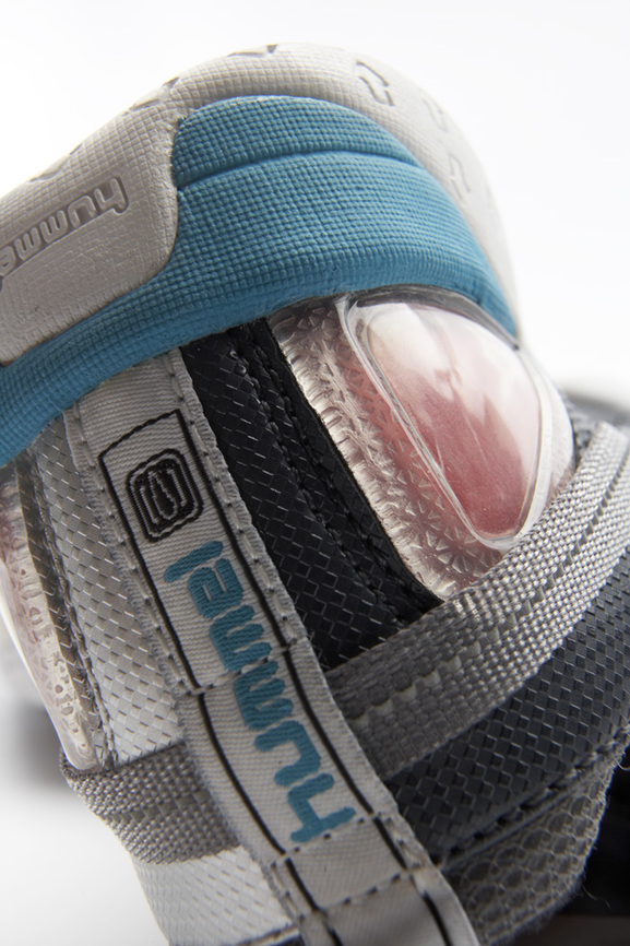

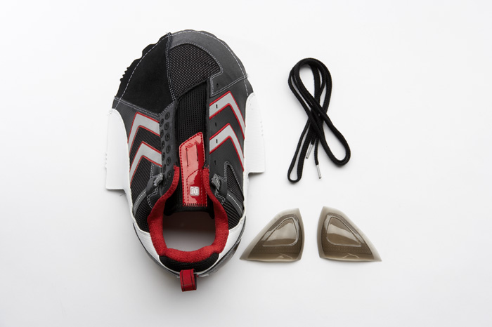

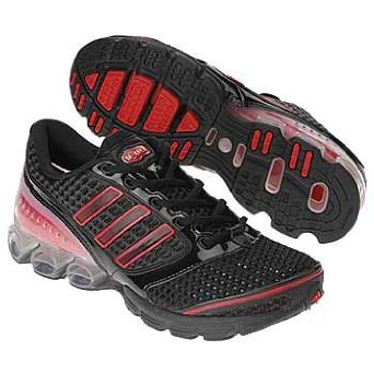

Is this kind of what you mean? These are Adidas Microbounce’s. I believe the sock liner is molded in the heel and comes up to protect the foot from the TPU. Seems like a lot of plastic and extra layers to me, but probably has a very 3D heel cup.
You can see the stitch line where the upper meets the TPU, the probably thinned out the TPU there locally so the edge is essentially a flange that is thin enough to stitch through.

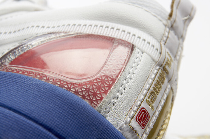

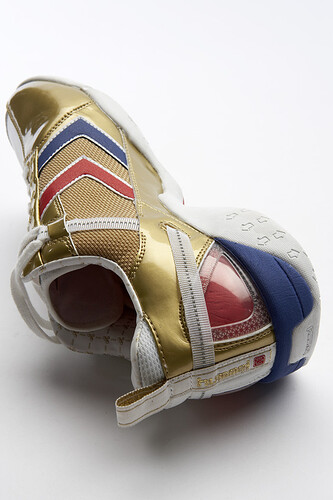

Yo, you’re awesome! That’s exactly what i mean and I’m thoroughly impressed you’ve managed to come up with an example. Seeing it also made me think I might have seen it on some Puma collabs:

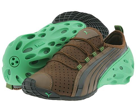

Yes, those Pumas has a similar construction as well, was that TPU or TPR? Can’t remember if those Pumas were rubber or not. They were doing a “heel focus” theme for several years back in the 2000s
Do you remember these? Almost looked like Swiss cheese in the back…

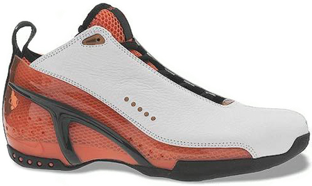

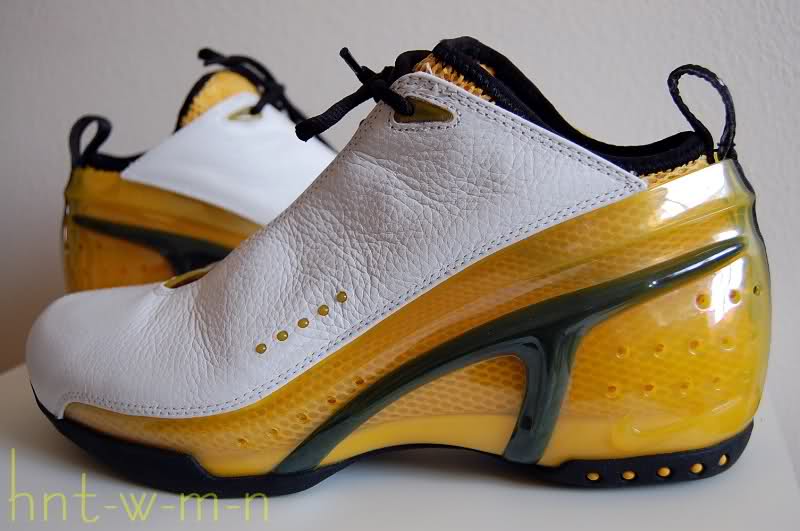

I found the Nikes I was looking for. The Zoom Ultraflight: That was bugging me!

I do remember the swiss cheese one’s, thought they were great, even tried them on but I remember not liking how rigid and clunky the heel felt.
The Ultraflight construction pic, YES.
I’ve done this. Treatment of the inside edge of the TPU important if there is no lining covering it. Typically would have a lining material covering that edge to avoid a sharp edge. (BTW, these were out before the Adi posted above).
Part I believe was a nominal thickness of 3.0mm with the thin part under the leather 1.2mm. I don’t think we had a stitch groove, but rather just the thinner material to stitch through and the difference of thickness to help align the part.
