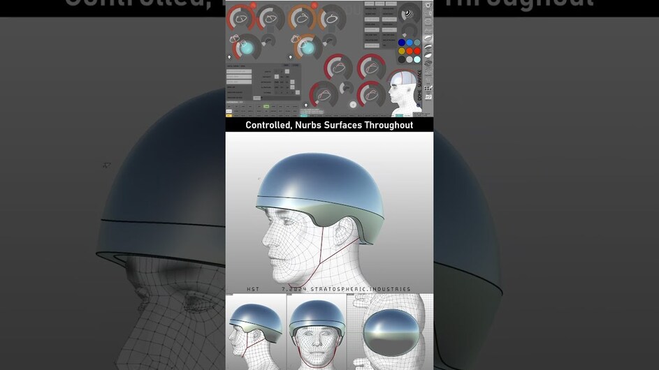

To begin, there’s a need for a designer-accessible parametric model wrapped in a UI. Here’s a practical example of such an approach applied to surface creation for helmets:
( 24" touchscreen interface on the top third of the screen, CAD window bottom 2/3, 10X speed)
The underlying concept of this project, HST, focuses on helmet shapes using single-span surfaces. These surfaces are challenging to parameterize and typically require manual control point manipulation to achieve desired forms. Single-span surfaces excel in aesthetics and serve as foundational elements for functional and stylistic components throughout the design process.
Parametric models enable extensive and complex manipulations with strategic inputs. These inputs can be trained into specific AI models, such as a custom ChatGPT model.
Training involves designers describing their intent and monitoring changes within a 3D model, specifically adjustments in driving parameters.
Usage entails requesting modifications through verbal or image input, with the AI API delivering adjusted parametric settings and an instantaneous rebuild of the 3D model.
This approach marks a step towards leveraging AI for streamlined and intuitive design processes, tailored to specific industrial needs and creative workflows.
HST implements a forward-thinking approach to integrating parametric modeling with AI capabilities, specifically tailored for the demands of helmet design. By focusing on single-span surfaces and leveraging smart models, we aim to enhance both aesthetic quality and functional efficiency in the design process.

I don’t see any AI here. This is just a GUI for a grasshopper definition, a very complex and impressive one at that.
This is step one toward AI incorporation. I am the creator of the video and the UI wrapped grasshopper3D script.
The AI section is not yet documented in the video.
To train the custom AI, it’s my approach that there needs to be a pathway from the designer’s intent to factors in the geometry.
The first step is a GUI that can directly drive the geometry. This is shown in the video.
Thanks :blush:.
The next step is specifying the rules/guides for the AI engine. Spending a lot of time inputting various model states, and narrating the changes to link the language, and the modified geometric states, factors and images. Training. First with my experience, and then hopefully other designers to round it out.
The goal is to be able to enter changes verbally and have the LLM language processing control variables. True, at this point the ease is so high that further facilitating changes by voice is extra, but I expect some surprises.
The next update will be more clearly linked with the LLM engine.
