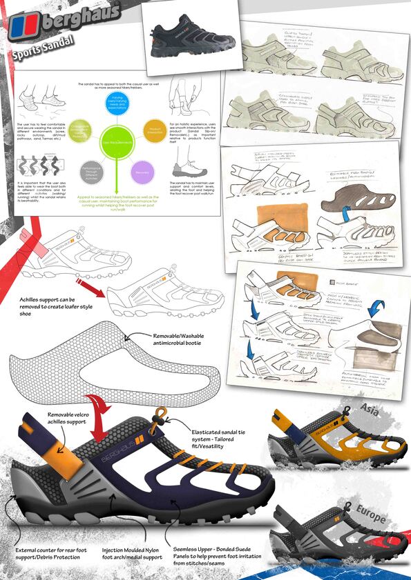

I posted up last week sometime about differing colourways for different markets etc, so though I’d post the mini projects I referred to for critique. Thanks for all the feedback previously!
The first concept is a 3-4 season trekking boot, leather upper, press bonded outsole is meant to appeal to seasoned trekkers while reflect advances in footwear materials/tech.
The second concept is a low-cut trekking shoe with moulded outsole, designed to merchandise with the boot.
The third concept is a sandal (sports/outdoor) that is meant to work alongside the Berghaus Pro Rush Shoe.
All Feedback Appreciated!
Cheers
