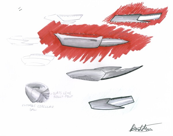

New stuff…
More new stuff
maybe this can help you to improve your skills…
best regards.
Anuruddha23
We are all mentioning the same things. You might want to start with our feedback and post that before moving on to other stuff.

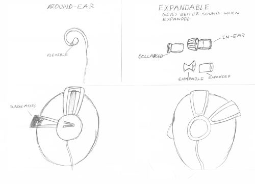

I’ve seen that book before, but I was about to get this one Product Design Books, Hardware and Software. Which one has more on perspective, and is better for me?
I thought I was doing what you guys said, I did a bunch of cubes, and the headphones were assigned to me. and I do lines, I just don’t post them up. What am I missing? :neutral_face:
My bad. Sorry keep posting. It would be great to see you practice cubes and stuff as well.
New sketches, been busy last few weeks…
a few things that i think would really help you.
  1. use templates (ellipse templates and circle templates) and guides (rulers) as you get started. these will make your designs much more believable and controlled.
  2. understand proportions. I think the phones are about the right size, but your desk looked just a bit too static. this will come with looking at things all the time. start at dwr.com and look at all the ways designers communicate with different size legs, padding, etc to determine different feels.
  3. slow down and add details. details make a design. for example, your phone with a wrap around screen has potential to be hot, but if you take a closer look at something even as simple as an iphone, you will notice how many details there are behind such a simple form.
