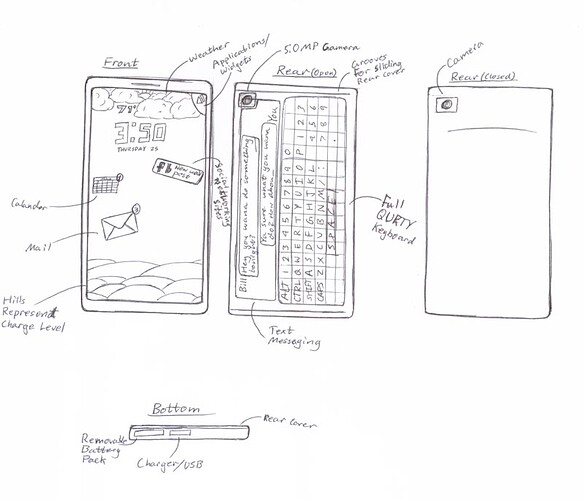

Hi everyone, I’m 15 and want to be an industrial designer one day. Here’s some of the stuff I’ve done, constructive criticism please[/img]
I need to work on the circles…

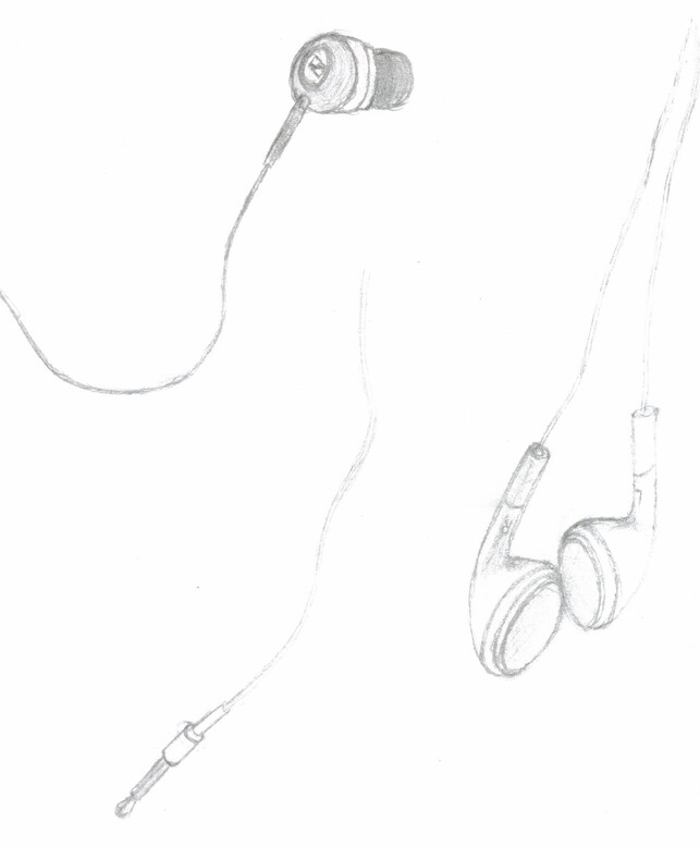

Some better sketches… tips please…
i think what might really help you in your sketching, as it has helped me, is to just take more time on each sketch; on each line even. like a practice swing in golf, make a couple of practice strokes just to help you visualize where you are going with your pen and what kind of line you want to make. when you see that line, try and make a faster stroke rather than a slow one, as that will lend to giving your lines a bit of a squiggly and unstable feel. it may seem tedious and time consuming, but just relax, take plenty of time, use plenty of paper, and enjoy making very clean, almost spot-on perspective lines. yes you need to practice a shit load, but if you keep practicing with squiggly lines and out of perspective sketches, nothing will improve. in fact, it will probably be harder further down the road to break those habits.
so my main advice is to slow down, take your time, and enjoy making clean, in perspective lines. reward and notice the good sketches you make, rather than noticing every little out of perspective or squiggly line you make; that will definitely just piss you off, as it used to do to me haha :slight_smile:
i also forgot to add that when you make your strokes don’t try and stop right at the intersection of other lines: draw past them. personally i love seeing nice, clean, expressive strokes that have a personality to them. the point is to be loose when you sketch, so enjoy running right past that corner of the cube your making. also, when you do your initial line work, barely touch the paper with your pen, pencil, marker, etc.
hope that helps. if you want i can upload some sketches ive done using this technique and show you some before sketches to see how much it helps lol! :slight_smile:
also, practice the laws of perspective. draw cubes with different vanishing points, horizon lines, etc, until it starts ‘looking’ right. an awesome sketch will look off with wrong perspective, but a crappy drawing with good perspecive can always look decent.

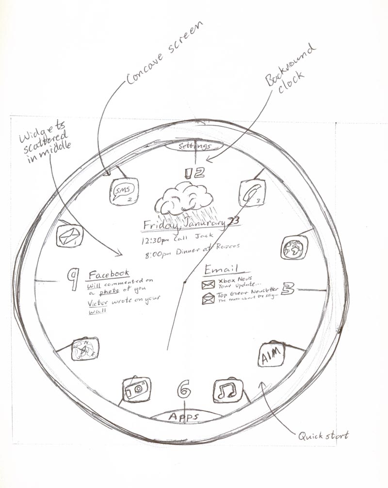

Some new stuff…
New stuff… my scanner broke after these…
New stuff…
I agree with all of the above. You need to get the basics down before you move to the more complicated shapes. Practice drawing lines, circles, ellipses and cubes. Get your prospective right and then you could move on to more complicated shapes. Once you understand the basic everything else will come easy. Keep going, ever bit of practice helps. :laughing:
