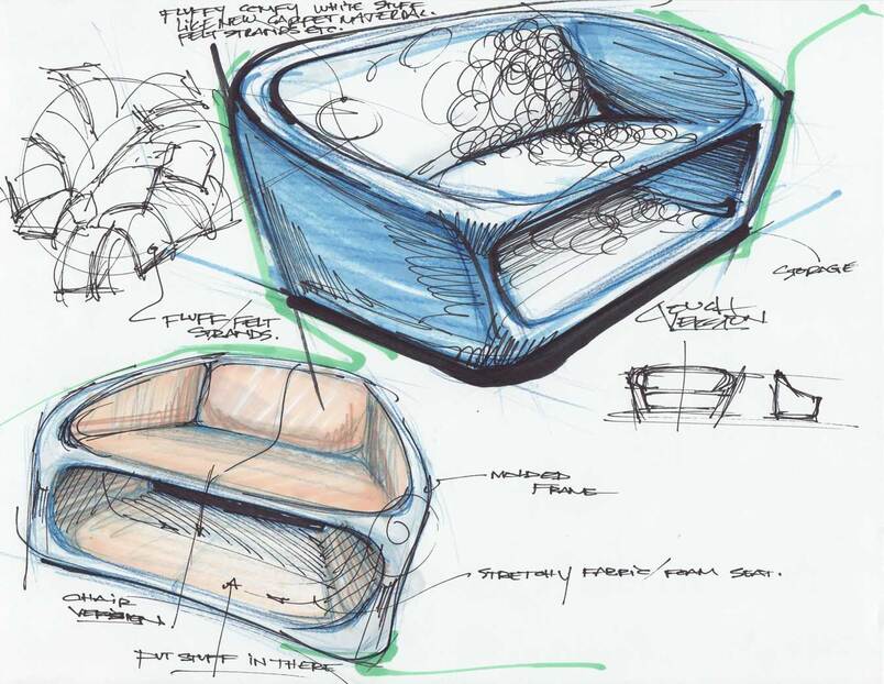

OK, here it goes… I’m finally able to postsome work… hope you can give me some feedback. Heres my story, Just got done with two years at Art Institute in Seattle (a school i will save for another topic)…I’m looking to xfer for a bachelors soon and am in need of some advice regarding my work - where to start etc… anything is helpfull - thanks!

a good start, I think you are in a decent place for a sophomore. Where are you looking at transferring to? Keep working on that lignweight and fill your forms out more, a lot of it feels a bit sucked in.

Frankly, my advice would be to get out of the area. Emily Carr is good. Outside of that, get to Cali… Art Center, Art Academy, San Jose State, whatever. A few years in Cali is a good thing.
oh, and sucked in as in Anemic, a little hungry (a little too much on the negative curvatures). Michelangelo didn’t believe in negative form on the body, only the radiused intersection between positive forms. A little more positive form will bring your sketches to life, make them look stronger, faster, more real and substantial vs weak or melted.
