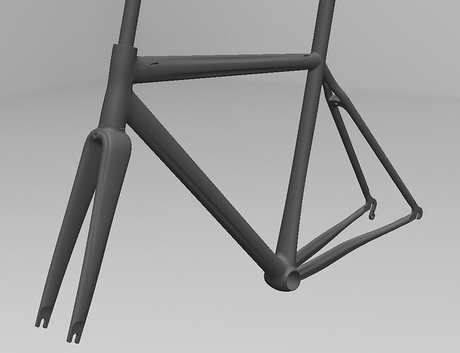

http://proetools.com/courses/solidworks/solidworksweek-long-surfacing-intensive part of my tubular frame structures class
