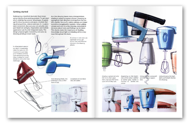

(Sketching sites: IDsketching.com, Sketch-a-day any books by scott robertson sketching by koos eissen ← a must Yo (Michael Di Tullo) as some great resources on his webste. Pick up a pen, grab some paper and sketch away!)
I’d get a book, something like Sketching by Koose Eissen and Roselien Steur. It covers the basics and has some nice sketching styles… There’s another thread on here about sketching books too.
Go through it and practice the fundamentals you see. Sketch every day and try to mimic good examples you find on the web and it will yield much improvement. Post stuff here if you feel thick skinned - people will be frank and tell you how you’re doing.
